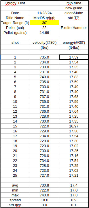

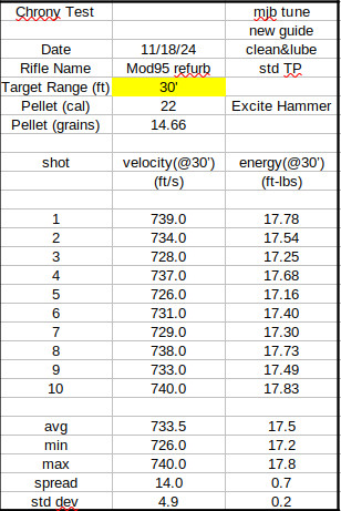

This is a summary of the results from some tests I documented on the UK Chinese Airgun Forum (UKCAF).
I have a couple of co2 rifles, however this is my first PCP. I'm enjoying the experience and my group size has reduced compared to the other guns I use - this gun is accurate up to the ranges I have tested it (up to 40 yards).
This is a UK 2017 model Hatsan AT44-10 in .177. It was purchased used, however an anti-tamper screw was still installed. As far as I am aware settings were UK stock - ensuring the power is below the 12 FPE legal limits here in the UK.

If/when I have permission I will attach the excel spreadsheet I have used to record the full shot strings for the tests completed so far.
The most recent test with the weaker hammer spring (Test 5 above) gave very good results from shots 1 to 120. There was a noticable drop in FPS from shot 137 onwards, which messed up the results for the full shot string when shots 1 to 140 were included. I will likely keep my shot count to 120 when at the range.
I used the H&N Excite Econ II pellets for test 5 because I had run out of the Excite Hammer used for most of the previous tests and did not want to waste my remaining RWS Superfield pellets. Shooting with the same spring tension and switching pellets for JSB Heavy increased my FPE to around 11.5. I will be using these pellets for shooting as they group well and suit my gun.
I noticed a pattern in tests 4 and 5 - both of which were completed with the Lane Lancet v9 regulator installed and set to 90 BAR. When the pressure in the air cylinder dropped to close to (and possibly below) the regulator pressure there seemed to be a slight spike in FPS/power. This can be observed in the attached spreadsheet - refer to shots 115 to 125 in both tests.
My stirrup pump has now failed and further tests and shooting is on hold until I get a replacement or fix the pump.
