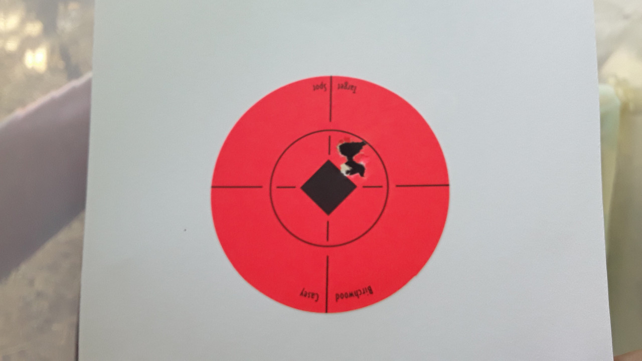

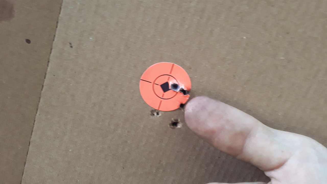

Here's a before grouping
And after

Here's the grouping shot with the William's 5dAG and new front sight.
