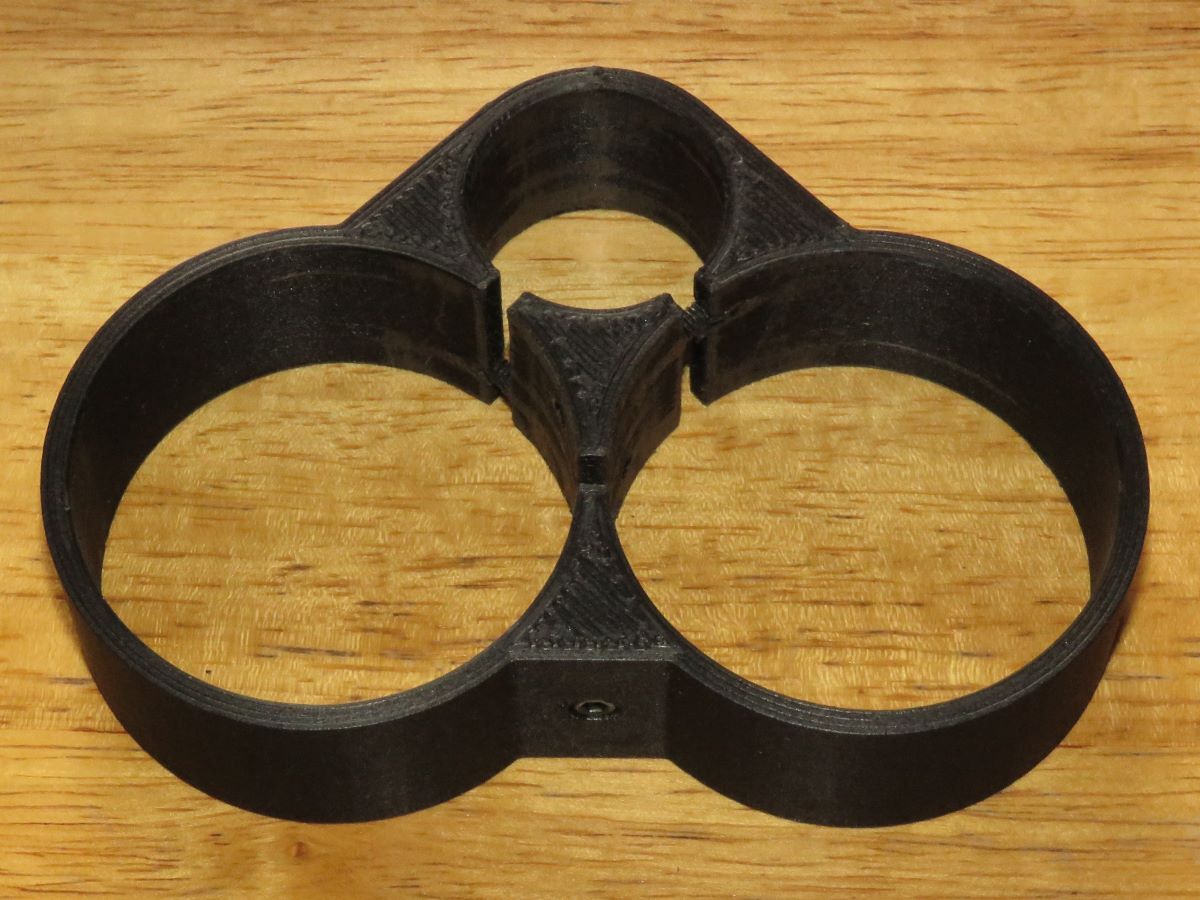

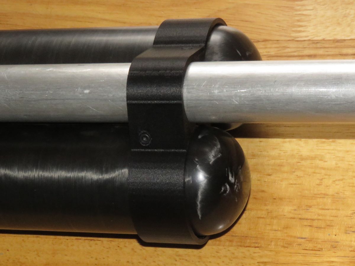

I was originally going to just use a hose clamp and spacer block to attach the rear of my twin bottles to the main tube (plenum) of my benchrest rifles, but Scott (Scotchmo) inspired me to 3D print them.... Here are the results....
There are three 6-32 x 1.25" SHCSs at different heights, passing through the webs between the tubes and threaded into the triangular center insert.... With the screws loose, the clamp slides into place, and snugging them up makes the assembly rigid....
It certainly looks better than a hose clamp.... Material is Bambu CF-PETG, printed with a 0.6mm nozzle and a 0.9mm line width in 2.3 hours each (I made 2)....

Great job.
Someone reading this is thinking, "Now why didn't I think of that? "
