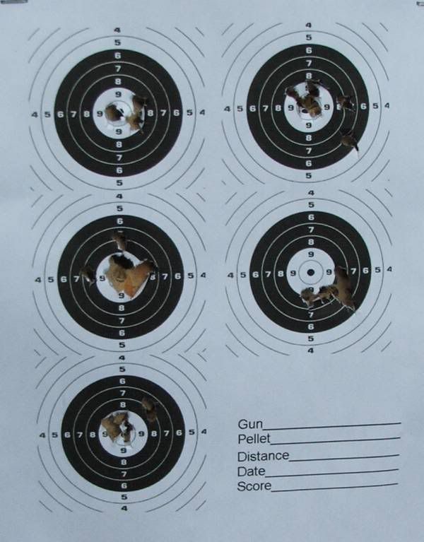

87 shots into break-in and I just wanted to share something. Take a look at the bottom Right target. I
know
I took 5 shots. I always line my pellets up next to me so I don't lose count. (I've started talking to them too but that's another issue, "Ok #3... you know what you need to do.")
Did that 5th shot sneak between the 10s or between the 6 & 7? I guess it could have been a total flier, but I haven't shot a Meisterkugeln through the new rifle yet that's landed further than 1.5" from where I thought I was aiming. So far, she seems to like those best. The Super-H-Point are in second place with Superdomes... eh. Not so hot so far. I'll probably just keep using the Ms or SHPs although I only have a small tin of Meisterkugeln. SHPs it is!
