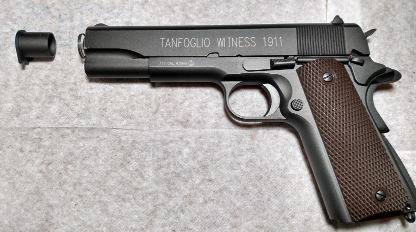

Short version-I think I steered you backwards-leave the barrel bushing OUT before you try to put the slide back on, see if that helps...

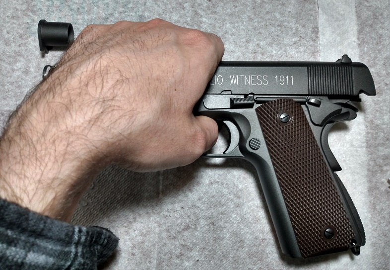

I start by taking it out:
Then I hook my thumb into the front of the trigger guard, like so-and line up the disassembly notch/remove the pin:

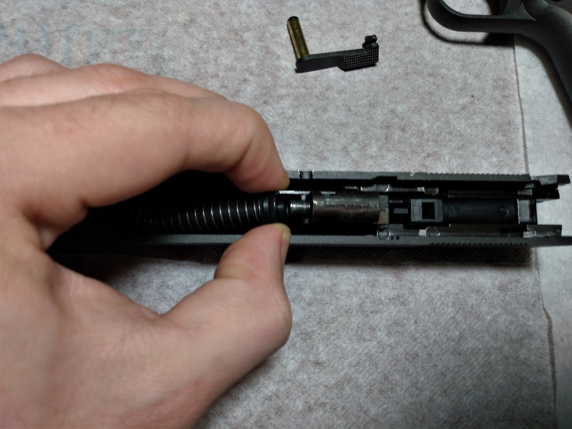

Slide comes off:

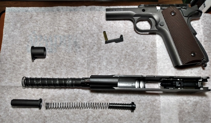

Take out the main recoil spring, guide, and plunger:
Slide the barrel assembly out the front of the slide, and you're completely disassembled:

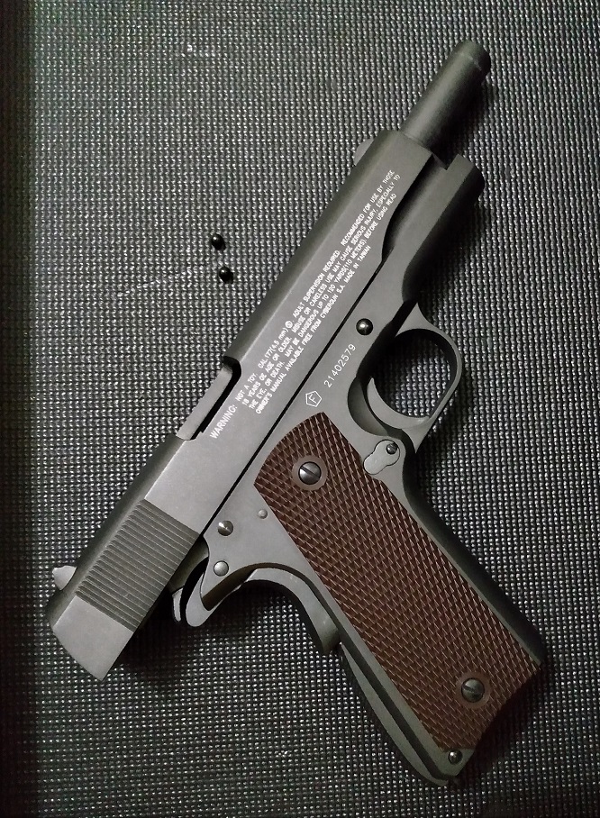

Put the barrel back into the slide, and reinstall the plunger, recoil spring, and guide rod-I *think* not putting the barrel bushing back in yet is the key, but not sure...
Slide it back on with the thumb hooked in the trigger guard-gives you a bit more control-c0ck the hammer first, makes it easier...
For me, the holes pretty well line right up-sometimes I have to move the slide a bit further back to get the pin started, but that's all...
