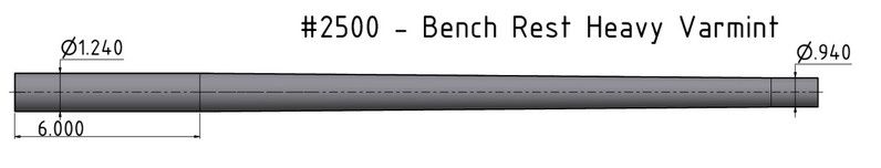

https://www.lothar-walther.com/gun-barrel-blanks/rifle-barrels/standard-european/1079/barrel-blank-twist-5.9-4-6x30mm-od-1.26-l-26.18-cr-moly-steel?c=34
I haven't decided whether to use this profile, or something a bit lighter....
Here is a drawing of the bullet I have asked Al to make a mold for.... It is a full 4 calibers long, and made for the 5.9" twist of the 4.6mm barrel from LW....
This is very much a matter of finding the fastest twist barrel I could afford in a small caliber, and building the bullet and gun around it.... It will take about 3000 psi to get into the 900's and the plenum is good for the full 4500 psi at a 3.5:1 safety margin.... There will be 1.4 litres of air (85 CI), so if I can achieve an efficiency of 1.0 FPE/CI, at 85 FPE I should get about 70 shots with a 1000 psi (70 bar) drop in tank pressure.... I hope it all comes together....
