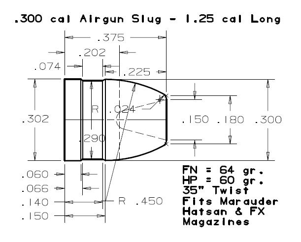

Are you talking about this one?....I had nothing to do with those, Al did them himself, patterned after typical airgun slugs.... That slug, scaled up to .30 cal would weigh about 67 gr.... Next time I am talking to him, I can mention that a .30 cal version of about 45-50 gr. is desired.... The problem I can see is that there would be no parallel body left at that weight.... The closest I have is this....That is a FB version of my 75-79 BBT in .30 cal.... neither of which has NOE made yet....Bob
That image was the .25 cal, I'll mention to Al there is interest in a 45-50 gr. in .30 cal.... IMO on the light side for a slug, but I'll see what he says....Bob
Quote from: rsterne on July 03, 2022, 06:10:29 PMThat image was the .25 cal, I'll mention to Al there is interest in a 45-50 gr. in .30 cal.... IMO on the light side for a slug, but I'll see what he says....Bob I think 55-60 would be good
