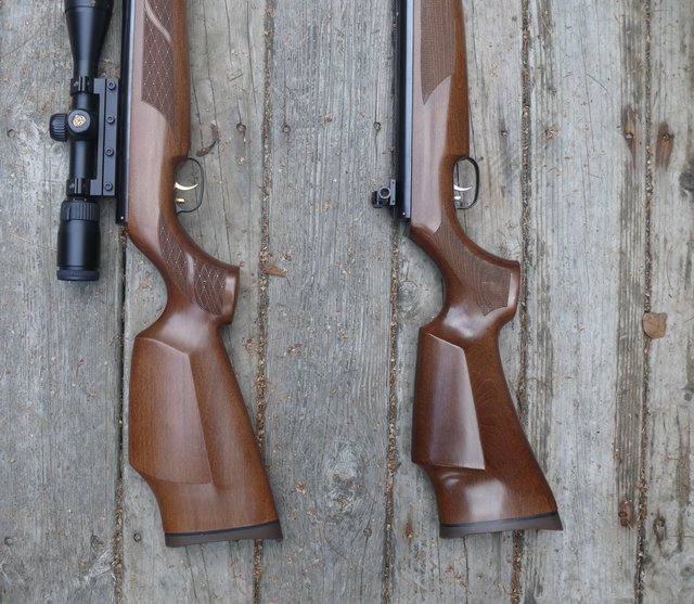

For years and years, Weihrauch made the 77 with open sights AND a stock well fitted for open sights use, as it had been from the early 80's start, while the 97 was basically a 77 without open sights and a high comb for scope use.
For some inexplicable reason, around 2012 or so, Weihrauch opted to fit the 77 also with a high-comb, unfit-for-irons stock. They basically cut away the options and introduced redundancy. Now, a HW77 is a gun that is still supplied with fine open sights, but no way to use them. Kinda reminds me of the HW95 I had to sell for the same reason.
As I understand it, the HW77's long reign at the FT circuit ended when the AA TX200 was introduced in the early 90's. But in recent years, the HW97 has claimed the top dog title. I see recent, little-used HW97's for sale all the time. I see HW77's second-hand maybe 1/5 of the time.
I'd consider buying an early, low-comb 77 if one was available at a reasonable price. That gun is far, far more desireable to me than any of the others mentioned above.

We bought an '87 vintage RWS45 at an estate auction for a gentleman that was retiring from shooting due to health issues. Though he kept the 45 as his around the house gun and didn't compete with it, he treated it with the same care as his high dollar PCP competition guns. Included the excellent made in Japan RWS 4x AO scope when we bought it. Not a gun I shoot on a regular basis, but when I do shoot it, I appreciate the old school quality and shooting experience.
As for the 77, we bought the 97K and the 77K during summer about five years or six years, ago. The 77K on mine did have a slightly lower comb than the 97 and I could use the 77 with iron sights, though the comb might still be too high for someone with a larger face. Have no idea how any other vintage 77 stock compares, though.
