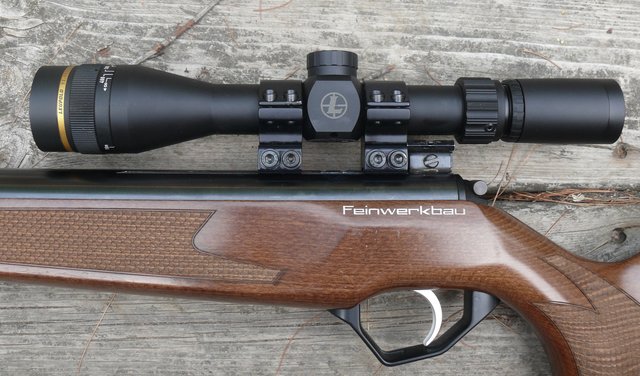

Absolutely do NOT use a conventional springer mount/rings with a threaded stop pin unless you want to mar up the receiver of the new Sport. Bad advice. Just be aware that even with that "proper" Sportsmatch one-piece mount for the FWB Sport, I still got mount slippage, twice, even after using a thread locker. Those traditional cross grooves that FWB uses on the Sport were appropriate for the vintage FWB 124s and 127s with their lower power levels, but they should not have been used on the new Sport with its power levels and sharper recoil. My solution for scoping my Sport has been to ditch the heavier one piece FWB appropriate mount and replace it with the lighter two piece FWB Sport TO-3 rings. Next, I ditched the much heavier Hawke Airmax scope for the light Leupold Freedom 3-9 EFR. Also used a 11mm to weaver adapter behind the rear ring as a scope stop. So far, so good.
