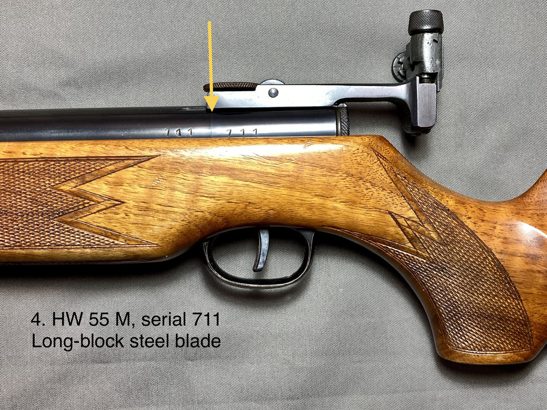

Recently traded some information with a forum pal about older HW 55 trigger details, and thought the resulting pics might be of interest.
This is the oldest 55 I have (1952?). Among many other differences from newer examples, note the threaded-on rear block which is much shorter than on more modern HW's (arrow shows the joint), and the heavy cast trigger guard. The stamped trigger blade is straight from the 55's parent, the original HW 50 sporter; a 2-stage pull with a simple sear-engagement adjustment screw on the rear face of the receiver.
This is one of the rare double-set triggers (1952-3?). The DST has nothing in common with the standard unit. It's a self-contained unit attached to the stock only, with a "flying" hammer on top that strikes a modified sear lever protruding below the action, and a unique trigger guard. Other DST's were built around the later long-block actions, and are different in detail.
Next evolution of the short-block trigger (1953?), a solid milled steel blade with a pull-adjustment screw behind. The internal design has intermediate levers giving a very nice pull.
In the mid-1950's, Weihrauch re-designed their basic architecture for a longer trigger block (arrow at joint - 1954?). This affected all their rifles (which at the time was only three models, the HW 35, 50, and 55); and was so significant that they re-started their serial numbers! This steel trigger operates similarly to the final short-block one though.

One final note, all of HW's early rifles use the same sequence of serial numbers. in other words, by 1970 they had manufactured 350,000 guns, but not that many HW 55's.
