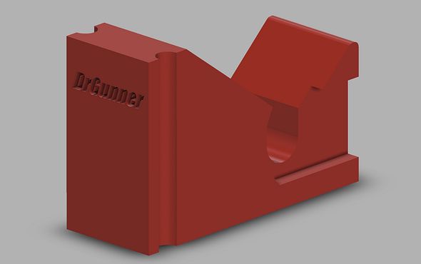

I’m going to have to design and print a single-shot tray, I’m kind of used to single shot guns and l will probably use it without the magazine most of the time for now as I have a couple boxes of NSA slugs that are too large for the magazine, due to miscommunication from the vendor. Again thank goodness I didn’t buy a mold that casts longer slugs.
I am in the process of designing a single shot tray for this rifle and as I tinker with the 3-D printed prototype for it, I will try to come up with a solution for this problem that I can then adapt to the magazines. But- until I get there, I’d like your suggestions on what to try. It appears that the dimple in the magazines is rather small compared to the detent ball which measures 3 mm wide at the base, so I might start by widening/deepening the dimple.I’m pretty certain that I could simply add a layer of tape or epoxy to the mags to give them a tighter fit, but I’d like to find a solution that WORKS without creating a force fit.Here’s my starter SST. My friend is 3D printing some prototypes for me to tinker with:Here’s his CAD mock-up. I should have a prototype soon.The final design will NOT stick out as far on the right side as my wooden one.When I’m done testing & tweaking, I’ll have extras made to give to members here. Look for a thread on “SST for AEA Challenger” & post in it if you want to try a freebie.DrGunner
