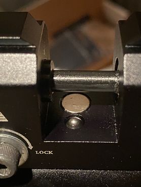

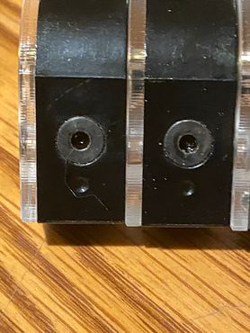

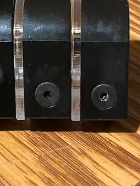

Quote from: Back_Roads on January 23, 2022, 12:39:40 AM I think a side effect of my Mrod mag cover swap was thet the .177 Mrod mag is thicker than the OE AEA clear cover, so it is a snug fit now.[smg id=8418] <~ Click BiggerI posted another thread asking for help/advice to try & solve the magazine shifting problem. I wonder- is there a vendor who sells Mrod mag components? It would be a simple thing to swap out the clear mag covers. I gotta say, I’m not a fan of the AEA mag design in general. I’m sure once you get used to it, they’re easy to load- but the whole wind the spring with the cover, load a pellet backwards from the front, then flip it & load the rest takes some getting used to. I’ve been spoiled by my Daystate & Artemis mags.
You can also adjust the barrel to help hold the magazine more securely.

Quote from: Spacebus on January 23, 2022, 09:26:00 AMYou can also adjust the barrel to help hold the magazine more securely.How would that be accomplished?From what I’ve learned in another thread I posted on this, it’s likely the spring in the mag is wound too tight. I’d certainly rather mess with spring tension in a replaceable magazine than degas and tear down the whole gun to remedy this...?

Quote from: DrGunner on January 23, 2022, 12:26:42 PMQuote from: Spacebus on January 23, 2022, 09:26:00 AMYou can also adjust the barrel to help hold the magazine more securely.How would that be accomplished?From what I’ve learned in another thread I posted on this, it’s likely the spring in the mag is wound too tight. I’d certainly rather mess with spring tension in a replaceable magazine than degas and tear down the whole gun to remedy this...?No need to degas. Do you have a shrouded barrel? If so remove the shroud. The barrel is held into the receiver by a large nut, 22mm (I think), and you just loosen this and back it off a turn or so. In addition to that nut the barrel is also threaded, you can turn the barrel until you get the desired friction against the magazine. After you get the correct tension, tighten the nut, replace the shroud, and you are done. The barrel is ported all the way around in the breech area, so there is no need for special alignment.
I had problems with mags and it was due to broken springs. Bin told me that they were having trouble with some mag springs breaking and sent me some replacements. While waiting I cut, and rewound the broken springs. The mags are considerably tighter than the originals and now work fine. Point is I doubt spring tension is causing your issue. Have you tried working the bolt with an empty magazine in it? I wonder if something is askew in the bolt or the magazine that is causing it to bind, then jump out.Jim
Quote from: Spacebus on January 23, 2022, 12:57:43 PMQuote from: DrGunner on January 23, 2022, 12:26:42 PMQuote from: Spacebus on January 23, 2022, 09:26:00 AMYou can also adjust the barrel to help hold the magazine more securely.How would that be accomplished?From what I’ve learned in another thread I posted on this, it’s likely the spring in the mag is wound too tight. I’d certainly rather mess with spring tension in a replaceable magazine than degas and tear down the whole gun to remedy this...?No need to degas. Do you have a shrouded barrel? If so remove the shroud. The barrel is held into the receiver by a large nut, 22mm (I think), and you just loosen this and back it off a turn or so. In addition to that nut the barrel is also threaded, you can turn the barrel until you get the desired friction against the magazine. After you get the correct tension, tighten the nut, replace the shroud, and you are done. The barrel is ported all the way around in the breech area, so there is no need for special alignment.Bin Tac from AEA got back to me and suggested exactly the same fix- so your advice was quite probably spot on. I’ll be going down to my man cave in a little while and removing the shroud, threading the barrel in a bit deeper & testing it.As I said above, I’ll report back here and in the help thread I posted when I’m done & have findings to report.Your sage advice & the responses by others are MUCH appreciated.MANNY- my sincere apologies for the thread hijack, that was NOT my intent. I did start a separate thread of my own for folks to respond to this problem, and I’d ask that everyone start using that thread for replies so that Manny’s thread can get back on track.Here’s a link to my thread:https://www.gatewaytoairguns.org/GTA/index.php?topic=195621.0Respectfully, DrGunner
