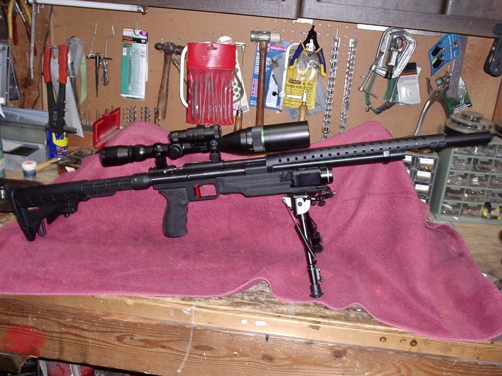

Umm...did you say that was a Disco?? DANG!!!!!!! Any numbers, like FPS or FPE???I have it tuned to shoot an average of 765 FPS with an extreme spread of 20 and a SD of 8 for a 12 shot string
Degriz, Where did you get the perforated barrel jacket? How is it mounted? Looks very cool! Any close-up pictures of your handiwork?Mike the jacket is from e-bay, made to fit mossberg shotguns, clamps on the front. screw together and forms a fit around the LDC cover. The LDC cover is the back half of my air tube which was cut when I shortened the dico.A little work with a dremmel tool and it fits nice.Pic rails I cut to size and mounted on the fore stock, both sides. Holds the stream light which I put a red filter on for lighting up the bunny eyes.I used Bed liner to paint the action, LDC cover and stock adaptor.
