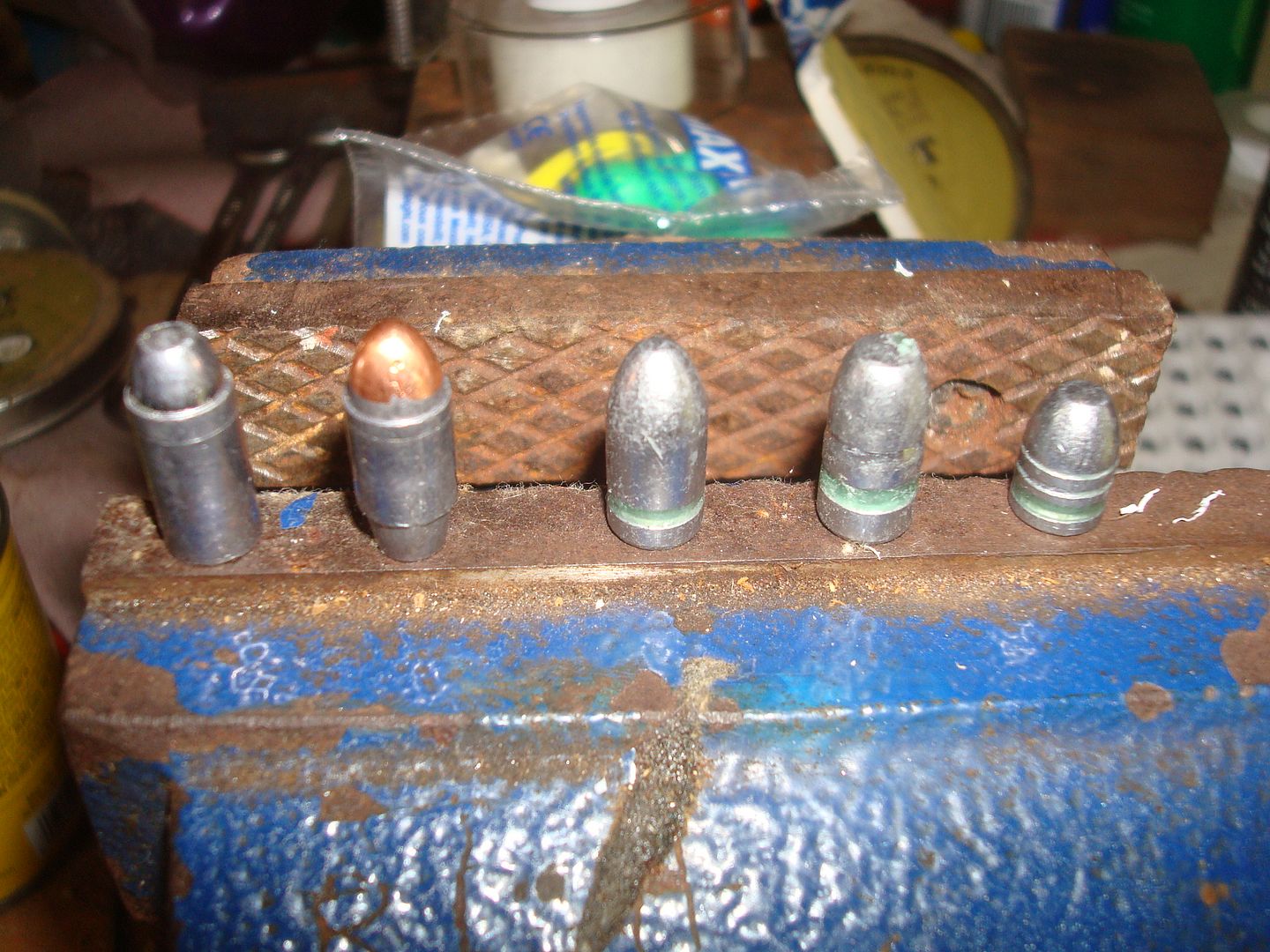

Finally got to do some testing today and the best I could do was with the 150gr Vogel hollow points. at 50yards off a shaky bench and 15mph variable wind was 1 1/4" at best. I tried from 122 to 150gr and the 150 was the best.I was hoping for a little tighter but at this point I feel comfortable taking a hog out to 50yrds.

Drat. I read that the DAQ doesn't like the slugs that have the wax/grease or whatever that stuff is. So I boiled a bunch of 130gr ones to remove it. I'm going to re-try them to see if it makes a difference. They are not hollow points.
