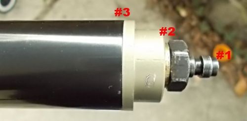

In the same gun ( different valve seats) which one would be prefered? I made both and will be testing this weekend. The steel I did from a reamer blank, its unfinished in the pic and the other is peek. The peek is .345 diameter, steel is .310.
