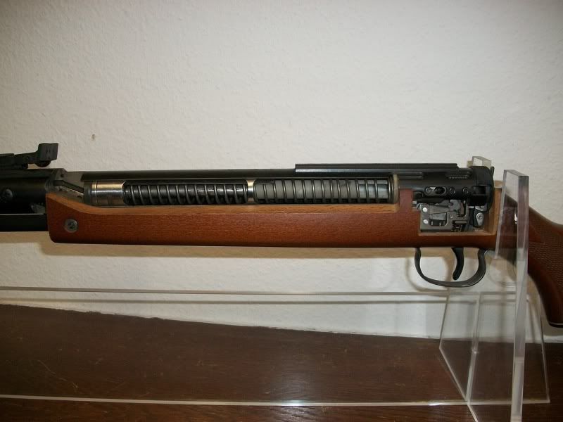

Curiously, has anyone seen a trans-section of the transfer port? I'll see if I can dig up the picture. Not at all what you guys might think.
OK, took a while but I found it.
Please note the transfer port on this 34. While you can bore it out at the pellet side all you want, you will find that it does not effect 90% of the port. The Cardews found that many guns had flat transfer ports on the piston side and a slight chamfering increased velocity. However, some manufacturers already did this. Not so sure about today but I'll bet many are. What you end up doing by increasing the hole on the port side is introduce a little vortexing. Air's a fluid and the shape of the port can increase or decrease efficiency in ways that seem contradictory. For example, certain shapes tend to create turbulence that impedes air flow even though you would think they ought to promote it. Others that look "wrong" have the opposite effect.
Something that the Cardews also discovered is that a long transfer port becomes less efficient since it provides more space for the combustion to take place in and, hence, a lower resulting pressure. Opening the port too much on either side adds to that volume.
But, they are your guns so have fun.
Oh, and that apparently inefficient offset port up there really isn't.
