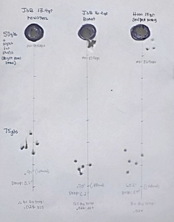

Rare...but it is one of the pellets I did try out to 75 yards.I don't normally shoot so far, but was trying heavier weights and as the 13.4's do so well in this particular rifle,included them in the long range tests (21gr.Piledrivers totally failed in this rifle). These would be the older version, not the "redesigned"version.
Not a great/clear picture...but I did take them out to 50 and then to 75 yards for a short head-to-head test with two heavier weights is an old BAM 50.
Idea here was to shoot the 50 yard target as near dead on as I could adjust the scope,then shoot the 75 yard target...then start over at 50 yards with the next pellet. Those 3 happened to be the best at 25 yard grouping,so they moved on to farther range.
(It's the BAm on the bottm...top on is a BAM 51 in .22):

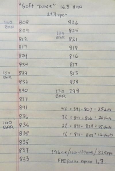

Nothing really specal about the rifle,same Chinese barrel ia alwarys had (a little polishing of the crown) andit'stuned to what I call a "soft tune"for this rifle (meaning it's running about about 3/4speed).
Soft tune:
These pellets didn'tmake the accuracy cut...but pretty representitive of the "soft tune". From13.4 to 16.3gr. would ahve beeen something between 24 and 25 foot poundsper shot.

Thanks Ribbon,
I now remembered that I saw your targets at 75 yd. Seriously nice shooting at 75 yd mainly by using old style Beast .177 it is absolutely unbelievable grouping .
