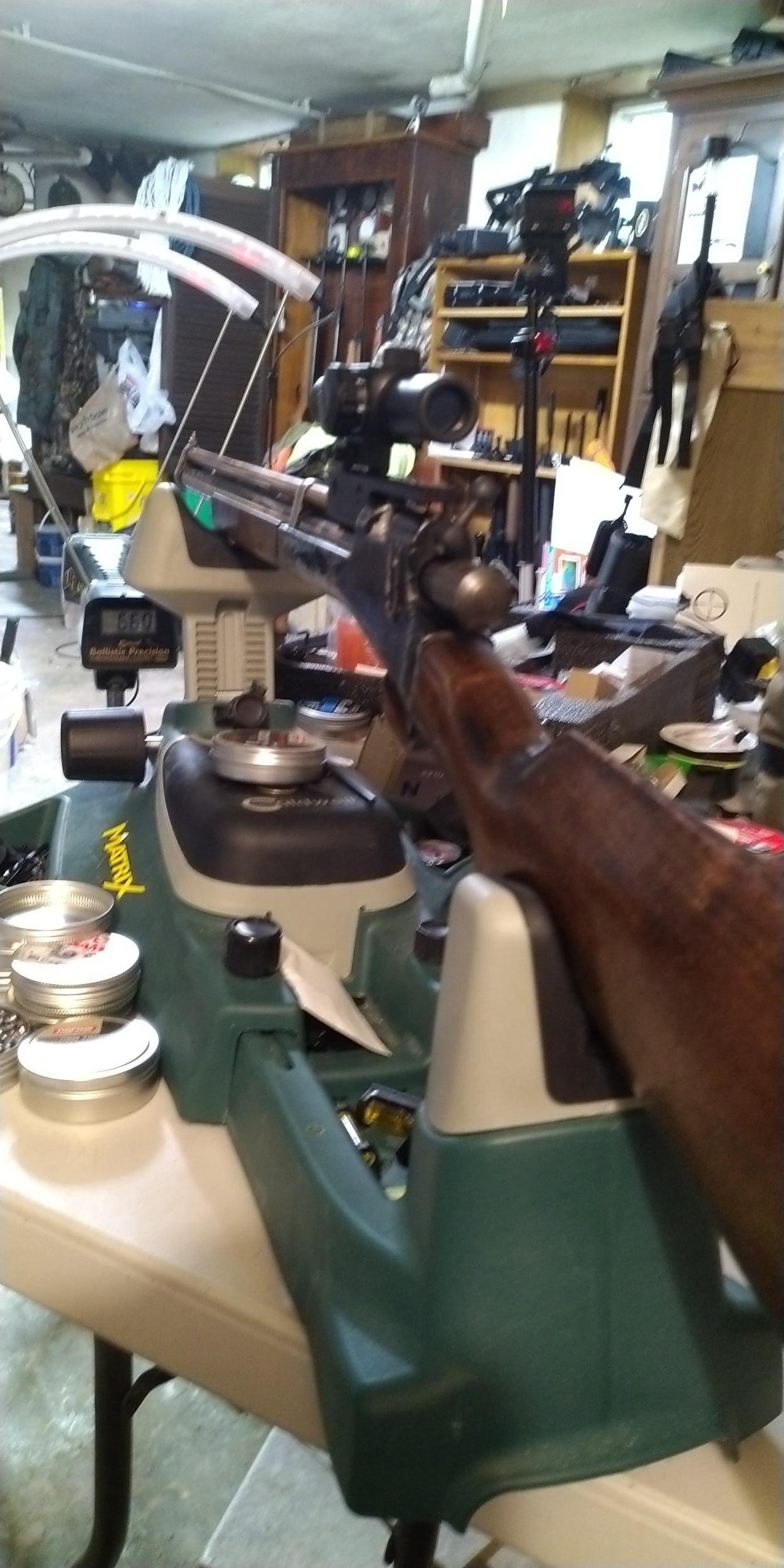

Got the 1968 HW 35 fixed up and shooting. Replaced broken trigger box pin, sear bushing and breech seal. Old breech seal was leather, new one is urethane or similar plastic. Piston seal was leather but just cleaned it up and treated it with neats foot oil. The breech seal was rotted and crumbling. The piston seal seemed to be in pretty good shape. Reassembling the record trigger was not much fun but eventually, after a lot of fiddling around, I got it done using a couple rubber bands to hold things in place. I still think the stock could look better. I only cleaned it with some Formbys antique furniture cleaner. I don't plan to refinish the stock, I like some patina. Probably will mount a scope tomorrow. It only dieseled a few times before settling down.

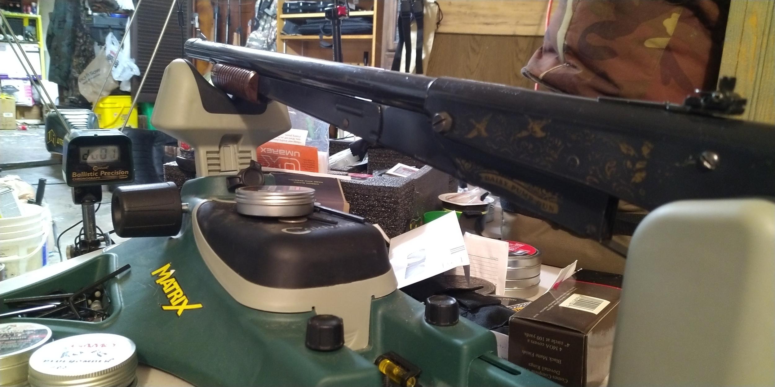

Finished up on rebuilding an old dDaisy Mod. 25 and gave it a test run 50 rounds later it seems to be back to normal.
I then rewarded myself by installing a scope mount and a nice 1" tube dot sight on my Crosman 100, and sighted it in and ran a few different pump #'s over the Crony. seems to be a small ragged hole developing in one place on the target the dot covers so all good, better than I was doing with the dish sight. Thanks Jon AKA eeler1
