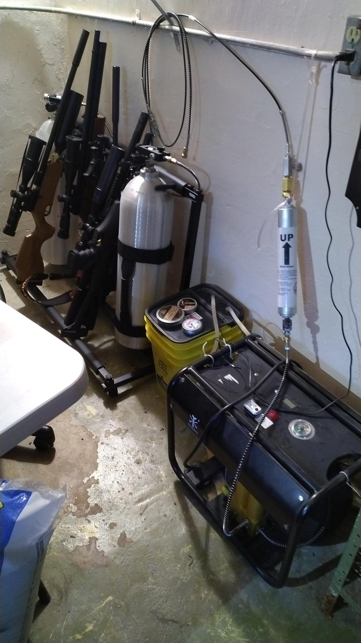

I put in a days work, assembling racks, moving tanks and airguns. Then installing a TKO Weaver left hand bolt breach on 362 #00760, Mounted a NC Star 2.5 x 30 duplex on it, groups shrank immensely
James..I assume you are topping off those tanks with the compressor the filling guns from the tanks? I like that setup. I may look into setting up a system like that with my dual cylinder MKII Extreme compressor.
Quote from: avator on April 14, 2024, 10:12:25 AMJames..I assume you are topping off those tanks with the compressor the filling guns from the tanks? I like that setup. I may look into setting up a system like that with my dual cylinder MKII Extreme compressor. Yes I run one tank below 3400, and the other I keep at above 2500, start my fill from the low pressure tank " if I remember what one it is : LOL. Then close the low side and finish the fill if needed with the higher pressure tank.
