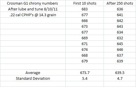

Now for chrony numbers in Feet per second.
With the numbers from the later group I'm looking at about 13.5 ft-lb's of energy which isn't bad but I was expecting more power.
Should I go with heavier pellets due to the stronger spring??

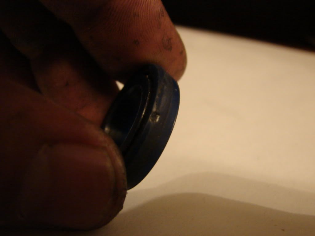

I know that I damaged the seal but could that cause that much power to be lost?

the deviation is good, maybe just shoot it a while see if those numbers come up some, i would have thought it would be shooting a little faster than that . i got a remington summit in 22 same power plant i will shoot it across the chrony tomorrow give you something to compare to. i am suprised no one else has had a say so maybe pm gene see what he has to say i would bet he knows. thanks david

I would have thought 630 to 650 was Ok for a .22
Remember the internals are basicly the same as a Gamo
in dimentions..& a standard .22 gamo is rated at 722...
and shoot around 630/650 in the real world....
In fact it was prob putting out more fpe as a .177
as it would have been shooting around 940fps
940 , 7.5g = 14.8fpe

with a standerd deviation of less then 5 it MAY be the seal but I wouldnt think so.... at 30 yards pellet choice would be my first pick....then muzzlecrown and technique.....

I took off a sliver large enough to see pushing the piston/seal past the cocking slot. I bought a new one when it gets here I am going to install it.

I have a picture of the seal I took out. But is it possible I damaged the spring with that seal? Or did I just get a bad spring?
I dunno, it's confusing because It was just shooting 680 the other day, but after 250 shots the velocity went down 40 fps, maybe this spring isn't rated for .22 cal? but really the .22 pellet has more surface area to be pushed on so using the 14.3 grain in .22 is prob the same pressure as the .177 with 7.9
