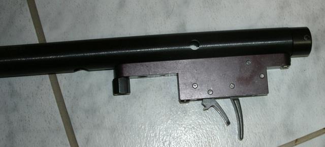

I am pretty sure a person could use secure a prod valve in a disco tube using the stock valve screw holes. You would just have to drill a new t-port in the tube. The Breech would sit a little bit forwards from the end of the tube.
Quote from: Matt15 on March 02, 2017, 09:12:58 AMI am pretty sure a person could use secure a prod valve in a disco tube using the stock valve screw holes. You would just have to drill a new t-port in the tube. The Breech would sit a little bit forwards from the end of the tube. Which I believe would also change your hammer throw? Is there enough bolt travel on the stock PROD breech to accommodate sliding it forward/back in relation to the trigger sears? I definitely think this is further down the rabbit hole than I'd want to go (at least on my 2400 HPA conversion).
I guess you just spend the extra $26 and use the maximus tube. Or, if one was so inclined, it looks like you could potentially redrill the 2400/disco tube for the new valve locations knowing they almost overlap. Joe posted pics over on the guild showing the specific differences between the 2 valves, and the direction that the screws move means the thin section between the existing discovery screw clearance in the tube and the screws required to fit a PROD valve would not be in the direction of pressure; HOWEVER, I have no idea what the result would be if this was ever accidentally overloaded. Personally, I'd want to do a pressure test and make sure all was safe. Since those pics show that the transfer port are in the same spot, I don't really see why you couldn't just use the discovery valve and drill/tap for the PROD breech screws? I'm guessing this is the fella that mated the PROD breech to the disco: http://www.gatewaytoairguns.org/GTA/index.php?topic=100696.msg945401#msg945401That being said, John, sorry for hijacking your thread!
What did bother me is the standard stock lug. It is same for disco and max. That is a very small diameter screw which holds the stock and stock screw. I'd think it would be very easy to strip out.
It looks like the original was 8-32 male and 1/4-20 on the female. The male length is 7/16", along with hex size and length. Measuring the thickness of the trigger pack and tube, shouldn't come close to hitting valve, since it is in that relief area. I think I'll stay with the existing, and make sure it is blue loctited in. Still going to do 3rd screw as long as valve has some roon for the clearance.

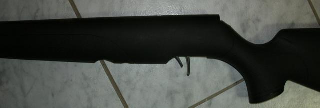

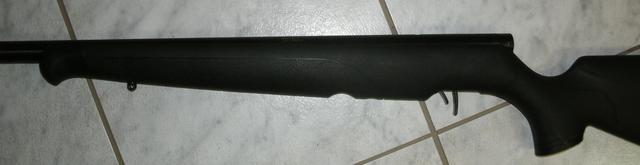

JohnI just looked closer at my Maximus for interference between the end cap and the stock and it does have just a very slight interference at the lower portion of the stock in the 4 and 8 o clock positions. I will be removing the action to relieve the stock on mine in those areas. It appears that action is possibly sitting just a smidge high at the rear in the stock and the end cap has forced some of the plastic of the stock outward in those areas.Thank you for mentioning that as I did not catch it when installing the action in the stock since its so slight it was not noticeable till you mentioned it.Mike
Quote from: buldawg76 on March 02, 2017, 03:16:31 PMJohnI just looked closer at my Maximus for interference between the end cap and the stock and it does have just a very slight interference at the lower portion of the stock in the 4 and 8 o clock positions. I will be removing the action to relieve the stock on mine in those areas. It appears that action is possibly sitting just a smidge high at the rear in the stock and the end cap has forced some of the plastic of the stock outward in those areas.Thank you for mentioning that as I did not catch it when installing the action in the stock since its so slight it was not noticeable till you mentioned it.Mike Mike,I did a test fit tube to stock, with and without an end cap. Yes, it will take a little trimming of the stock. Dowel rod or dremel won't be hard.
