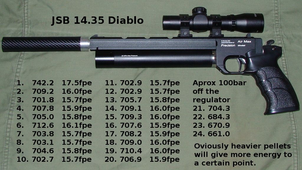

Okay, so if I'm reading this right, Donny... you're getting a 20 FPE tune on a .177 pistol that has only 67 CC volume and it's good for ~ 20 shots? On the regulator? Needless to say, that's really impressive.And I still think these little buggers would be magical with a .25 barrel. Yeah, it would be relatively slow- about like a .25 springer... which is perfect for short range on medium size things.

This morning before I went hunting I did a string with my latest adjustments, I had the regulator set too high for the hammer and the hammer was maxed.I backed of on the regulator a little and now I'm really seeing this regulator work better in the gun, I'm calling this my sweet spot for this gun. I must admit the more that I use the gun the better the trigger is (by far now), Rocker was right about these guns they're a lot of fun.
