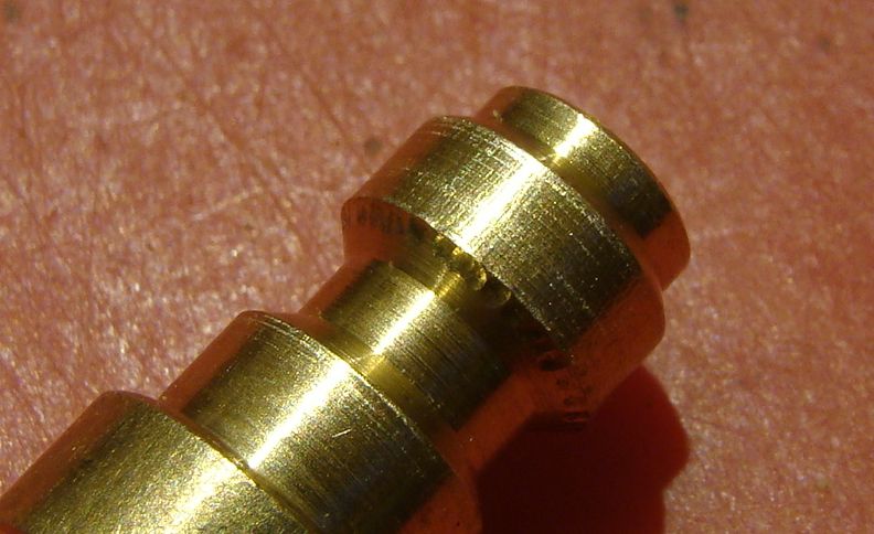

Quote from: shultz on May 18, 2017, 07:48:57 PMRallyshark,Not being able to really tighten the barrel is troubling me. You added a set screw to hold the little breech plug. If you had to do it again, would you?I nearly drilled and tapped both of my guns for an M3 set screw last night....just want to make sure I'm not making a mistake.I absolutely would do it again! It is easy, and doesn't mess with anything
