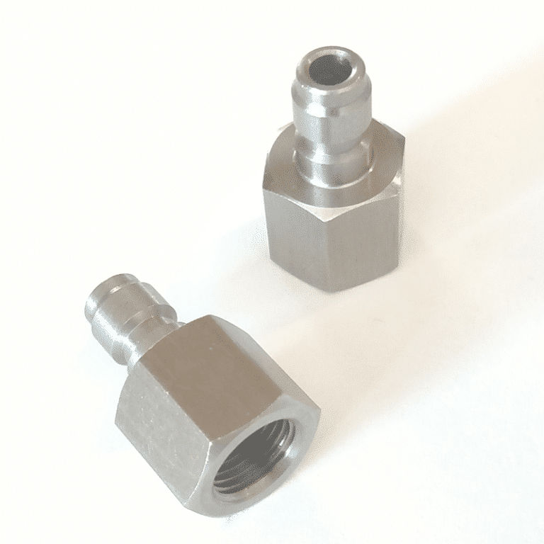

What I bought was this...To go with this....I plan to use this for filling the tanks at the paintball store. Cost $40 for the setup. Joe sells the same sort of thing in an assembly for $89.
Yes but you won't need the bleeder. The paintball place will have that on their fill equipment. I took mine apart as well. The inner part on mine looks a little wonky. That's why I decided just to get everything new.
Quote from: TerryH on January 22, 2017, 09:04:42 PMYes but you won't need the bleeder. The paintball place will have that on their fill equipment. I took mine apart as well. The inner part on mine looks a little wonky. That's why I decided just to get everything new.Wouldn't a bleeder be necessary to bleed off the air in the hill hose after filling the gun??? Am I missing something here......probably. Ed
