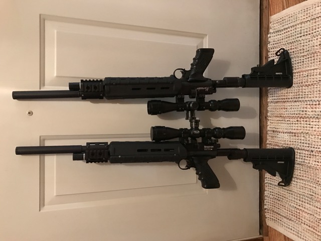

What's the dry weight on those rigs?
Love the look! What wrap around grip is that?
Very nice work. No 30 cal Prod yet!!!
Quote from: jp_over on December 18, 2016, 08:57:20 PMWhat's the dry weight on those rigs?Wet (scope, mag, and air): 6.5lb
Did you use the Prod breech or the 1720T breech?How did you get the mrod .177 mag to fit the breech too?
Quote from: screwwork on December 19, 2016, 11:44:09 PMDid you use the Prod breech or the 1720T breech?How did you get the mrod .177 mag to fit the breech too?The 1720 breech is too wide and has angled ends, which are good for fingers, but not mags. The barrel does not extend into breech for mag use, either. I used prod breech. That means you also have to turn down the Prod bolt to 177 dimensions.To use a Mrod mag, you need to shim the back of the breech (0.035") and flat sand the bottom of the mag until it fits in the barrel slot. You need to be careful, because it will be close to breaking thru. You can also flat sand the left side if you want that to be flush with breech. Alternately, if you have the equipment, you can slot the breech deeper.
Very nice work. No 30 cal Prod yet!!! Just kidding
