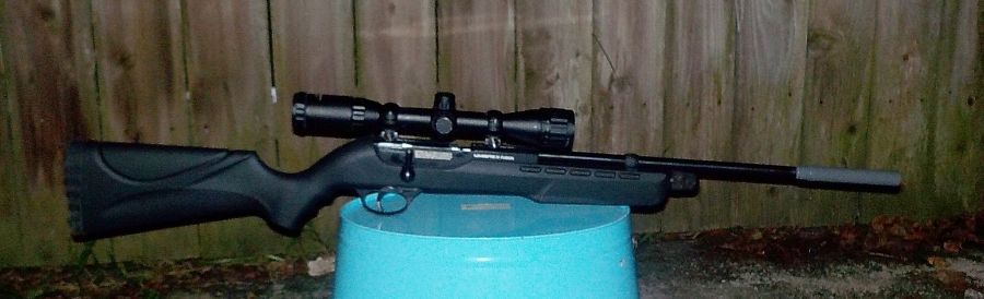

Seemed to work...but may be "playing possum". Have had a long relationship with this rifle, shooting great for a day or two, then scattering shots all over the place for the next few shooting sessions.
BAsic rifle (with oversized/ribbed/factory "pickle"):
There was one thing I hadn't tired: removing that giant "pickle" of an LDC and checking the crown on the barrel. I kind of dobuted the crown, as that's not likely to be good one dday and bad the next, but the shroud alignment could vary day-to-day.
It's a one-way trip, that LDC isn't made to be taken off....it's made to NOT be taken off. Combination of a groove on the barrel, ring in the goove, larger ring around that, and the shroud kind of molded over that system. Getting it off pretty much destroys it for reuse.
The LDC certainly does work, but it's pretty darned ugly, so destroying it to get at the end of the barrel didn't seem like much of a waste.
Caught me at night (darn daylight savings time) and with just a primer coat on the new LDC (will let it set for a couple of hours before putting on a black finish coating so they'll bond). But I was itching to try to get it sighted in and see if it was shooting well.
COULD BE that the little touch up on the crown and the new (not gonna move metal made) LDC "cured" it. Could be it's just playing possum again and will break out into scatter shots the next time it's tried on paper.
Past experinece makes me lean to the playing-possume theory, and I half expect it to shoot here-n-there tomorrow (or the next day...or the next).
Once painted black, that skinny LDC is going to look better....but I won't trust it until it has shot well for a few fills.
