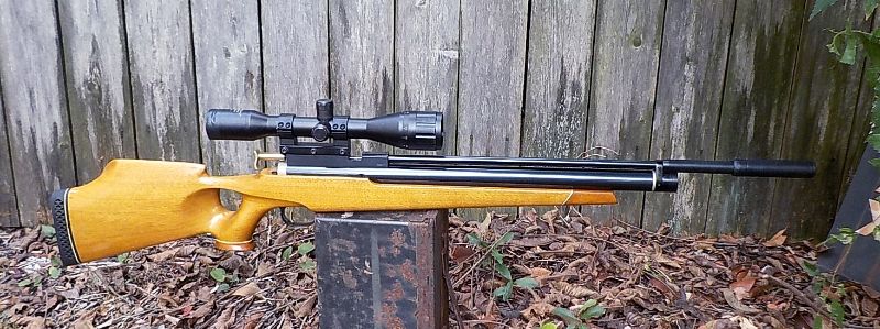

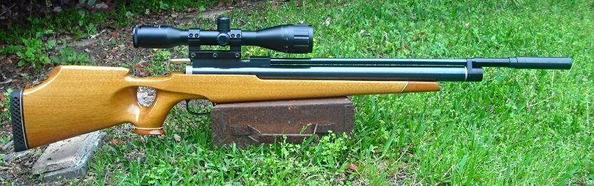

Test .22 rifle: BAM 51. NO CHANGES in barrel. Trying to fit the home-cast slugs to the barrel rather than the barrel to the slugs.
Rifle was left off shooting "normal" pellets to about 30 foot pounds with a low presure tune. Don't really want to retune it uless cast slugs seem like a possible option.

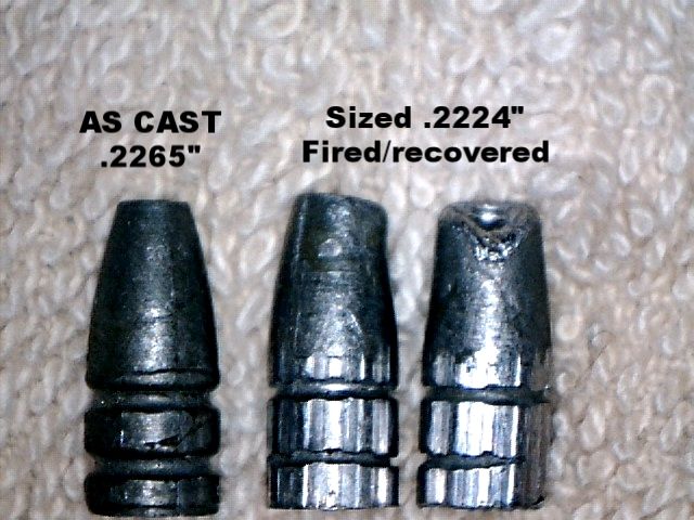

Only have one .22 centerfire mold and it's been modded to work with a 1:16 twist centerfire at 1100-1500fps. Base pour mold, with the base shortened a little to end up just under 50 grains (and pretty much remove the gas check base). Works fine in a .224" barrel sized to .225" and shot at 1100-1500fps.
With an airgun, it is way-way too fat. Smallest size sizer die II could rig up brought them down to .2224", which still needed a little "urging" with a rawhide mallet to close the bolt.
At least they took the rifling well without making tail-fins on the base, but still too fat and too long for an airgun barrel at 1/2 the speed they get used in reduced centerfire loadings.
LIKELY somthing like ..218/.219" would be tight, but work. Maybe .217"?

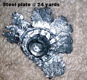

A little labor intensive to size them with the junk-yard collection at hand, so only made/tested 20. 10 went into chronograhp readings, 5 for one taget, and the last 5 for "capture" in test media (only 2 really survived in measurable shape).
The one at a steel plate certainly didn't survive:
It's also too long to stablize at this low speed (less than 1/2 the speed it usually gets shot). That's asking a whole lot of a 1:16 twist barrel. Need somthing both lighter and "blunter" (shorter).

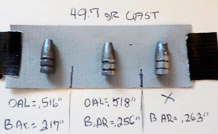

Start off by saying how nice it was to get the old warrior out for a little trigger time. Havne't had this BAM 51 out in quite some time (but it held it's air while it waited).
Cast bullets at least with what I have on hand, got worse.
Started life as a Lyman #225415 casting about 55gr. bullets (depending on the alloy...softer = heavier). Wouldn't shoot in an old (1930's-1940's) K-hornet's 1:16 twist.
So I lathed off almost all of the ga check base and use it as a plain base .22 bullet in that centerfire (as well as others). So long as it was loaded to go as fast as 1100 and no faster than 1500spf, it shot well.
So I tried that bullet in an airgun, with a smaller sized bore (requiring more sizing down). While th twist rate was the same 1:16, the airgun could only manage about 1/2 the speed.
For sizing, figured a way (by way of an old Lyman 310 tong-tool and using some dies in ways they were not intnded to be uses, figured out a way to evenly size down the cast byllets to .218"
BUT, as they got skinnier, they got a little longer too, adn the bearing area (B.Ar. on the picture) got longer too. Not a while lot longer in length as most of the transition from fat to skinny was taken up by the lube gooves.
Did find that sizing the bullets to .217-218" (and if I had to pick, would pick something about mid-point betwen the two) made it possible to chamber the pellets by hand (although, often a smack with the heeel of my hand).
Well...accuracy went to *(&^. velocity increased, but the slugs key-holed.
Think they are just too long to stablize at low speeds from a 1:16 barrel. It's not so much the weight as it is the OAL of the bullet. A nice blunt round nosed 50gr. slug would end up shorter, and likely end up shooting much better.
With what I have on hand, it "ain't gonna happen". Trying some pre-made, shorter, blunter ,217 and .218" slugs is a definated possibility.
