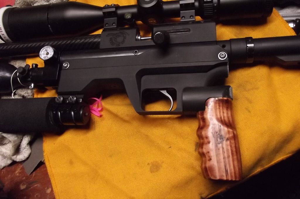

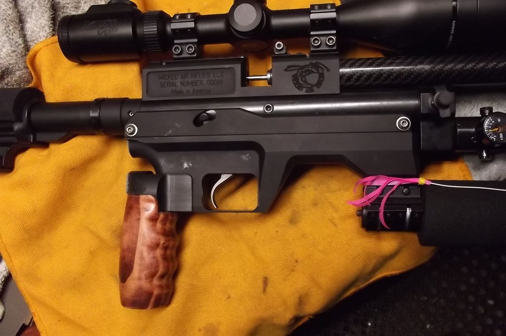

Issues with BIG HANDS .....
Grip size in general on AR15 type grips is just too small & the location / length to trigger blade rather short.
When doing Target work the Angle of grip tends to have too much back slope as well
So we made up some CUSTOM parts to fix all of these shortcomings
The new mounting block manufactured from Acetal ( Delrin ) that was proportioned to get a Set Back of @ 5/8" from the OEM AR type grip.
Back slope angle more in line with typical Vertical target grips of @ 5*
Grip portion just a shaped piece of Doug Fir cut from a 2x4
.... shaped to fit hand with some finger grooves.
The set back also allowed shooting / holding with a vertical thumb position resting on either back of grip adapter or on back side of receiver housing.
In shooting the hand positioning and hold options greatly increased along with overall comfort.
* Will keep it natural wood as we fine tune the shape, then Black truck bed paint it when satisfied.
