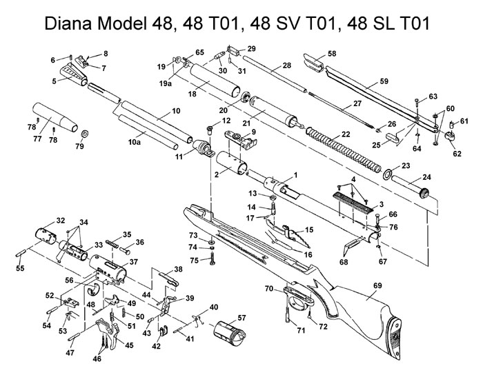

The shrouds will normally rotate when twisted. The front sight mount/muzzle weight is what keeps the shroud in place....if the muzzle weight starts to come loose the shroud will spin freely, just loosen set screws in the muzzle weight and push it back against the shroud while tightening the set screws, that will keep it snug. After shooting a 48/52/54 for awhile the muzzle weight will sometimes start to move and loosen the shroud....when this happens the POI will also start to change....tighten it and everything will be good again.
OK, I'm resurrecting this old thread where I noticed the d48 barrel shroud rotated. I'm now interested in removing the front sight housing. I backed out the set screws no problem but the housing would not budge with a decent amount of force applied to it. I did this once before on hatsan's front sight and it really got ugly quick with deforming the plastic. Perhaps a bit of heat from a hair drier might help? Any advice would be great. Thanks!
Could there be a second screw under the sliding part of the sight?
I meant to say whack the wrench in the breech to muzzle direction against the sight. Not like you're unscrewing the barrel. I'm sorry if I wasn't clear.Taso
