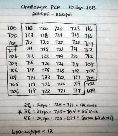

Hmm, so the 2k fill starts at the top of the bell curve. Before doing anything more invasive, I would try clipping a coil or two from the hammer spring and try to get a more useful bell curve. Can always shim it back a smidge if you clip off a little too much.Or of course if you plan to anchor the valve and fill to a higher pressure, that would be another way of approaching it.
So, here are some numbers I got the other night. I was shooting the Ruger pellets from Wally World. They are 8gr and were just right for my chrony testing.Created: 09-22-2016 20:51:21Description: .177 Maximus EuroNotes 1: 2kpsiNotes 2: Ruger HP .52g (8gr)Distance to Chrono (FT): 20.00Ballistic Coefficient: 1.000Bullet Weight (gr): 8.000Altitude (FT): 5280.0Temp: N/A Average: 719.34StdDev: 57.39Min: 571Max: 774Spread: 203True MV: 720.98Shots/sec: 0.03Group Size (IN): 0.00.
