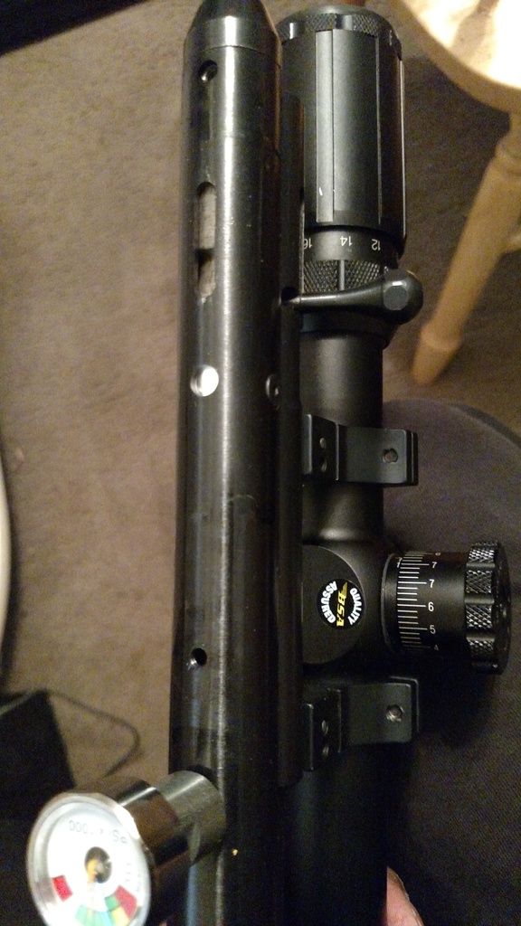

Monkeydad,
What is the length of that scope with the sunshade? I absolutely love the way it looks on that gun.....
Thank you,
John
Bucks County, Pennsylvania
.22 Benjamin Marauder slug gun project, Benjamin Trail Np XL 1500 "The Speed Demon"
Monkeydad1969
Posts: 4351
Real Name: Joe
Re: Beni Maximus Euro .177.
Reply #41 on:
September 28, 2016, 12:03:57 AM »
18" with, just over 15" w/o. I love it, too.
Joe

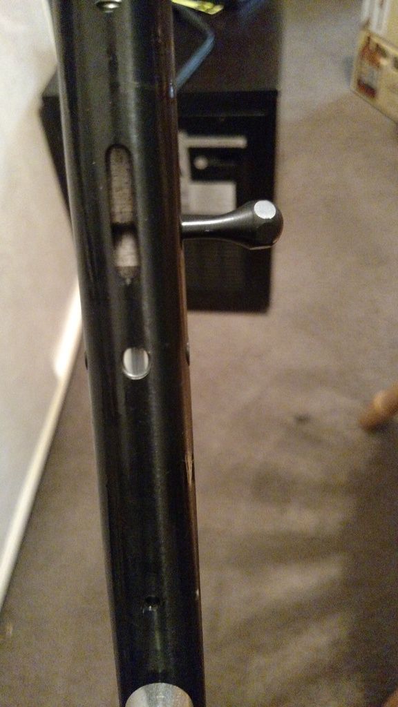

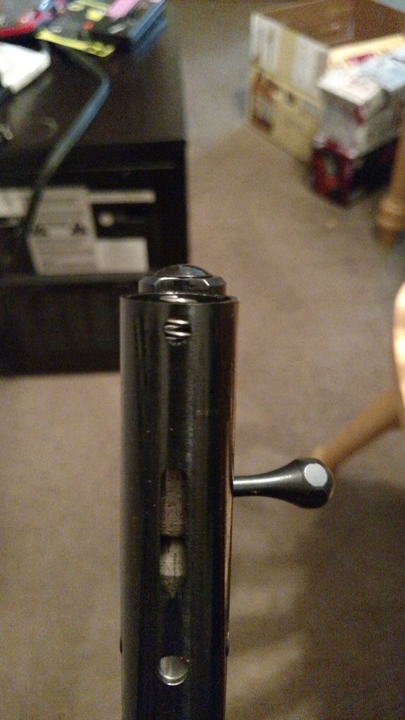

Seems like Crosman changed up the tubes, valves and screws on the Maximus---on top, compared to a Disco tube---on bottom. But at least the Disco tube fits, right?
Joe
Colorado---Aurora

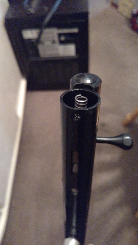

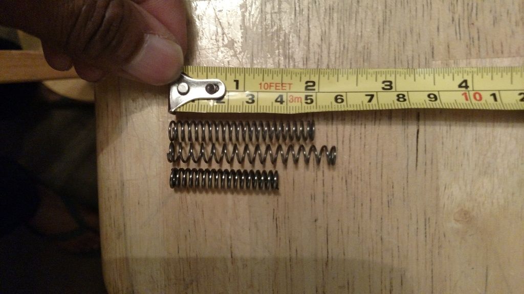

Reply #45 on:
October 09, 2016, 02:05:26 AM »
So, I did go into my Maximus. I wanted to see if it only had 2 valve retaining screws, and that's all it has holding the valve. Screw openings are .275. So if I went that far, why not check out the hammer spring. Very short is the first thought, then how heavy it is. Perfect for a Cothran valve. I have it next to a newer Disco spring (middle) and to a 13XX spring (next to tape measure). I think I'll go for broke and degas then take out the valve. Airgunning minds would like to know.
Joe
Last Edit: October 09, 2016, 02:07:16 AM by Monkeydad1969
Colorado---Aurora
