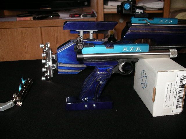

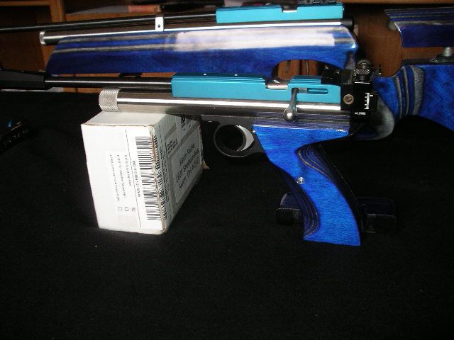

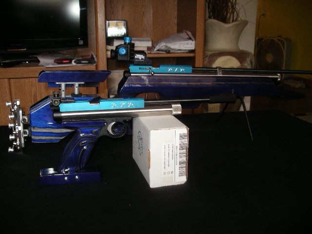

Good lock on your venture. That's pretty much what I've built as my avatar picture. Mine is a mic of aftermarket parts and standard crosman parts. Hard to get away without using some factory parts. Here is a better picture.
upload img

That is a beautiful pistol
I don't have anything agenced the factory parts. But there are better options out there so I am going with a lot of the top end choices. I really like that power adjuster. I have seen it before. Did you make that?

That's from cothran machine shop. The tube, breech, barrel bands and power adjuster are from there. The trigger group is a 1701/p-rod. The barrel is the lothar barrel from a 2300kt. Valve is a disco/ pro-top setup. More money than what it's worth but it is fun and shoots pretty well.
