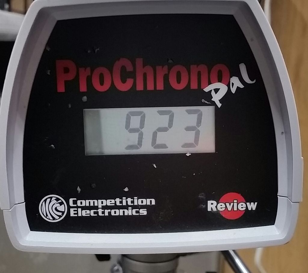

you need to spit a 7.9 outa there and see if you get 911 fps
so , you added a small bit of volume , increased the flow of that air, and then added hammer to get it into the barrel faster.. Awesome.. the .140 tp kinda finishes the job.. very cool

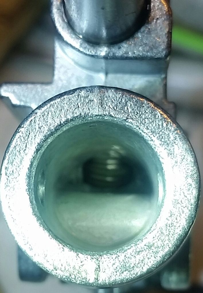

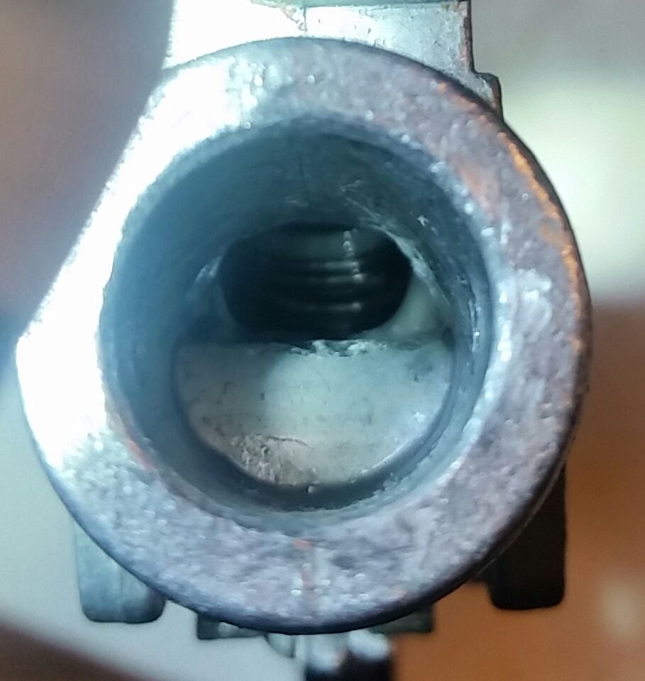

If you flatten the flooring wider (looking like a sideways D ) and put a radi on the edge like a waterfall it will flow even better Put a washer on the seat to protect it a from damage..
