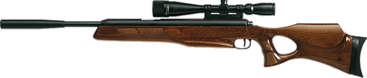

Not sure if this is a fair comparison.. being that one gun produces at least 3-4fpe more than the other.. but a tuned 54 can be superb in accuracy, and a lot better than a factory stock TX200.. although the 54 is very accurate out of the box as wel. But that's not comparing apples to apples. As an FYI, Hector Modena took 2nd place at the FT Nationals this year with his 54. Do not underestimate the 54 and its recoilless design.
Anyway, the "new 54" is now the 56 model with the T06 trigger. I would seriously be looking at the 56, not 54, but that's me. I strongly believe it is as good as the TX200 but with more power. There are just not many around yet to know for sure.
The wood and finish of the 56 are way better than the 54's, and it also has an adjustable butt pad. It also comes with the much praised new T06 trigger which has been measured between 1.8 and 2.2lbs from what I 've been reading, but mostly under 2lbs. Many say it is very very close to HW's Rekord trigger, if not equal to it. The 56's price is about $100 higher than the TX200, but the new 470 model (underlever) is very close to the TX200's price.
In all fairness I am not sure we can compared the 2 guns. The 54 or 56 (and 470) are Magnum Springers with >20fpe of kinetic energy. The TX200 is not. The 470 .22 is a "beast" and can produce very close to 900fps with 14.x pellets, but can still be very accurate. I doubt as accurate as the TX200, and would probably not be my 1st choice for FT competition. However, "detuned" or less powerful 54's are extremely accurate, and have proven themselves in many FT matches as well. They are more accurate than if they had full power. Obviously the main reason would be a more tame spring, which produces a smoother shot cycle alone by design. But, you usually can't go wrong with a TX200, although I know many that have sent them out as well for a full tune, as soon as they arrive new in the box. All springers benefit from a good tune, and the TX200 is no exception.
A pic of the 56:
