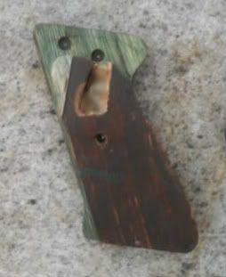

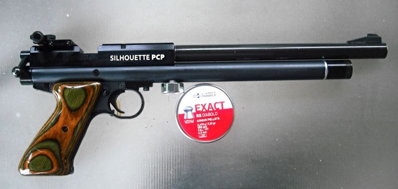

Can usually make a 2240 set of wood grips fit…depends on the thickness and how it was made to fit a 2240 frame.
This is an old 1700 and I’m not sure if the 1701 had some major changes or not (but as these modded grips will fit a P-Rod, it should work on a 1701). Difference is in the INSIDE of the grip frame outline, not the outside. Basically, in the below picture, it’s the upper right of the inside of the grip frame.
So thr two parts that can give trouble are the upper right corner and the large knurled nut for spring tension.
To get the 2240 grips to fit, had to cut a groove for the adjusting nut and trim the inside inletting.
These laminate grips were made with a section designed to fit INSIDE the grip frame, so the corner had to be cut to match the new grip frame. If your grips were made to lie on TOP of the grip frame, should only have to deal with the adjusting nut (which is a problem if the grip panels are thin).

Ribbonstone: The trigger assembly looks different for the 1701P as shown in the first picture below. The grips from the Custom Shop are shown in the next picture. They are also inset into the handle, but mostly clear the new trigger spring. I had to remove a small spot on the rear side of the inlet so the trigger weight knob would clear.
I have now switched the grips as shown in the third picture. The wood grips feel better than the stock grips and fit the size of the pistol better. The slight flex that I noticed is gone and it feels more precise. It's funny, but I don't notice the flex now that the OEM grips are on my 2300KT.
