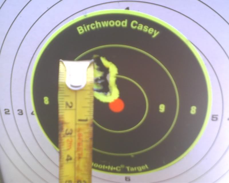

a few groups from before the washers
10 shots 20 yards crossman premier 14.3 hollowpoints

If you're happy, and it is sure grouping good for a new unit...I'd keep shooting it. You'll both get better with time. It's Not broke.

You only gain accuracy if your existing plastic washers are shot/not doing their job and judging by the vertical stringing of your groups, I'd say your gain will be "zero". Bad washers usually result in horizontal stringing. What you WILL gain will be long term durability and consistency and that is well worth the trouble and expense! To think, the bean counters made those parts out of plastic is outrageous! ..especially on a $300 gun!!

Your rifle is already grouping really well...
