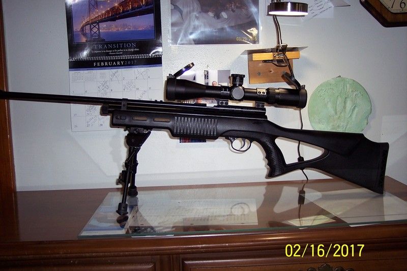

I dug out another of the MILO regs I had and after finally getting the 1600 psi set point I wanted tested at 2k then at 3k psi.
here is the 3k psi string .... I shot past where it fell off the reg just to see how it fell off ... I am quite happy with the ES and shot count.
