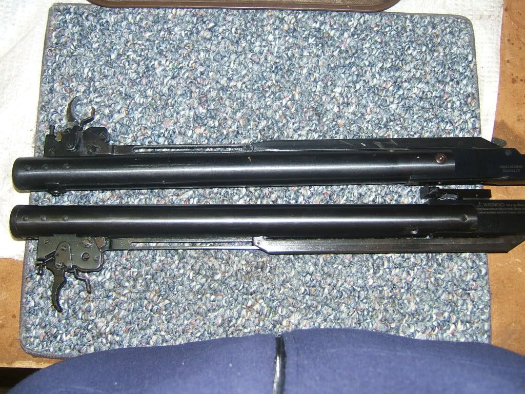

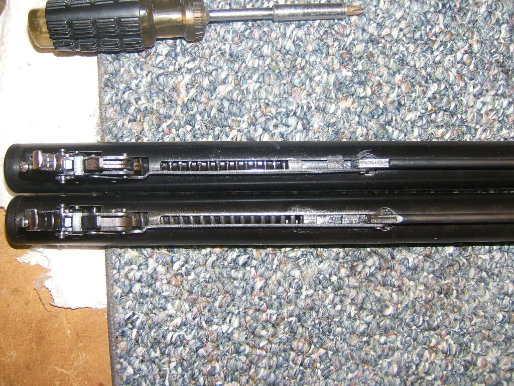

with a few minor changes because the action is quiet a bit longer then the stock rs2/tf-89 here are a couple comparison pics of the actions side by side RS2 on the top Walther on the bottom
can see here while the trigger group is in the same location the Walther has about a half inch longer stroke

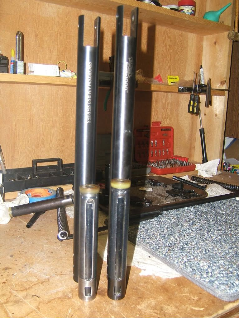

and a good side by side disassembled view that really shows how much longer the Walther tube and piston is.

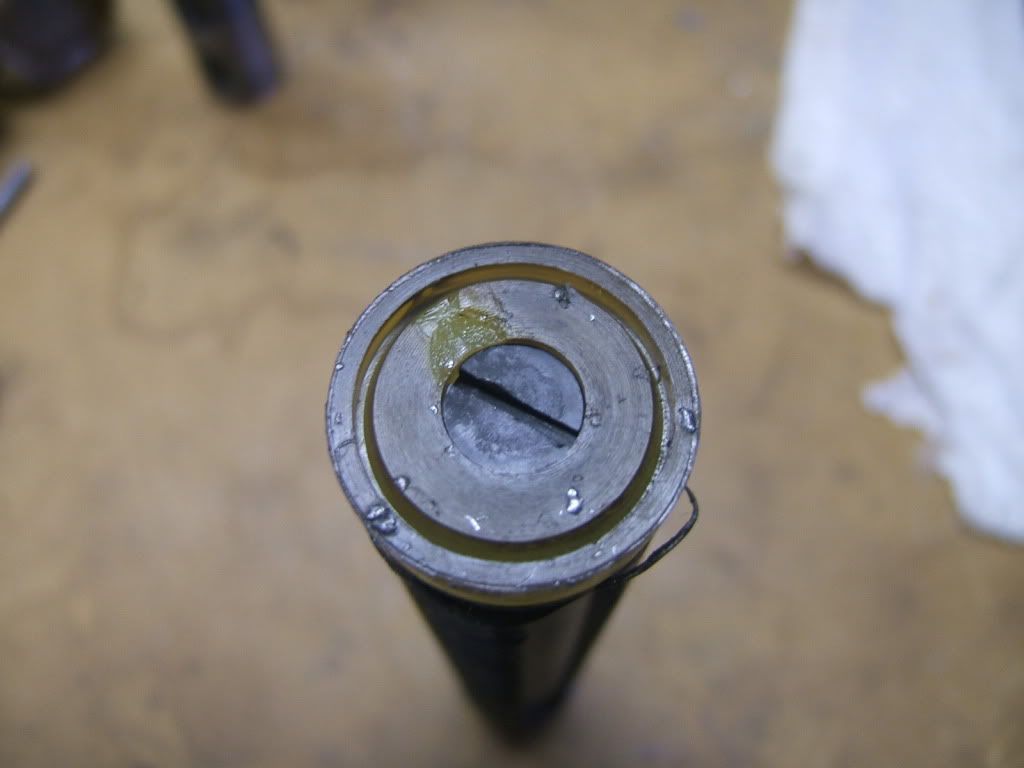

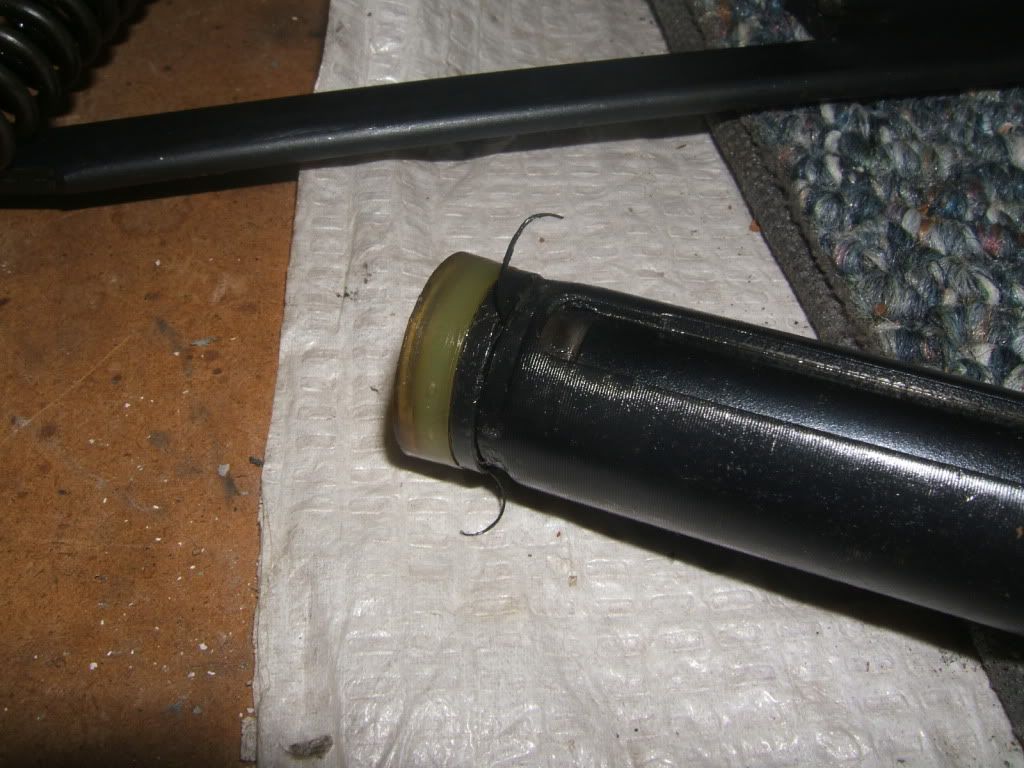

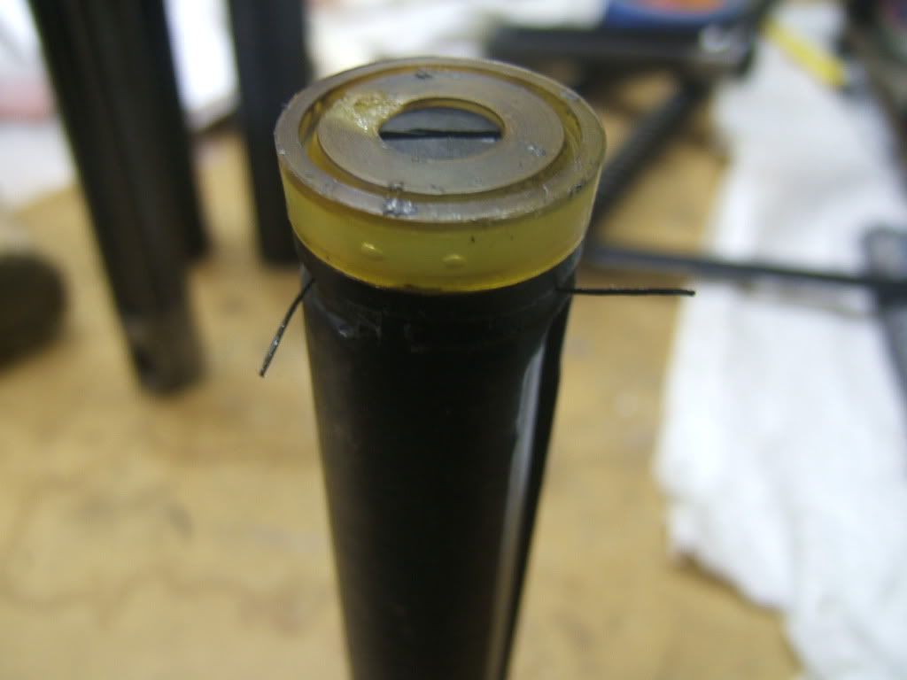

this poor piston had some NASTY burrs and a very bad seal
So anyways that all got cleaned up and fitted for a new maccari seal as per the RS2 build thread.

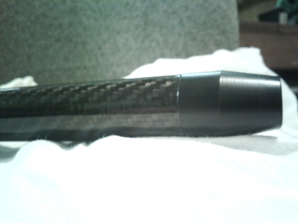

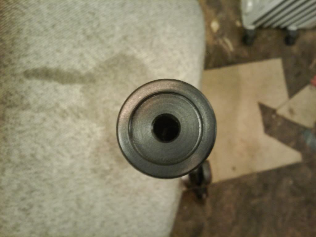

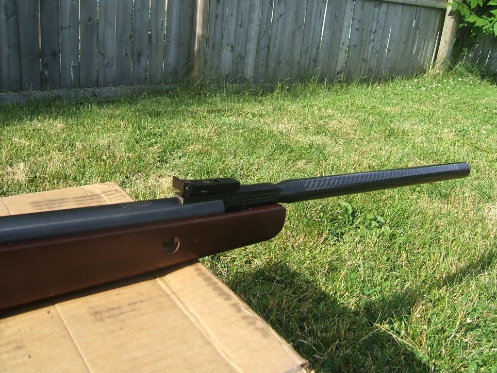

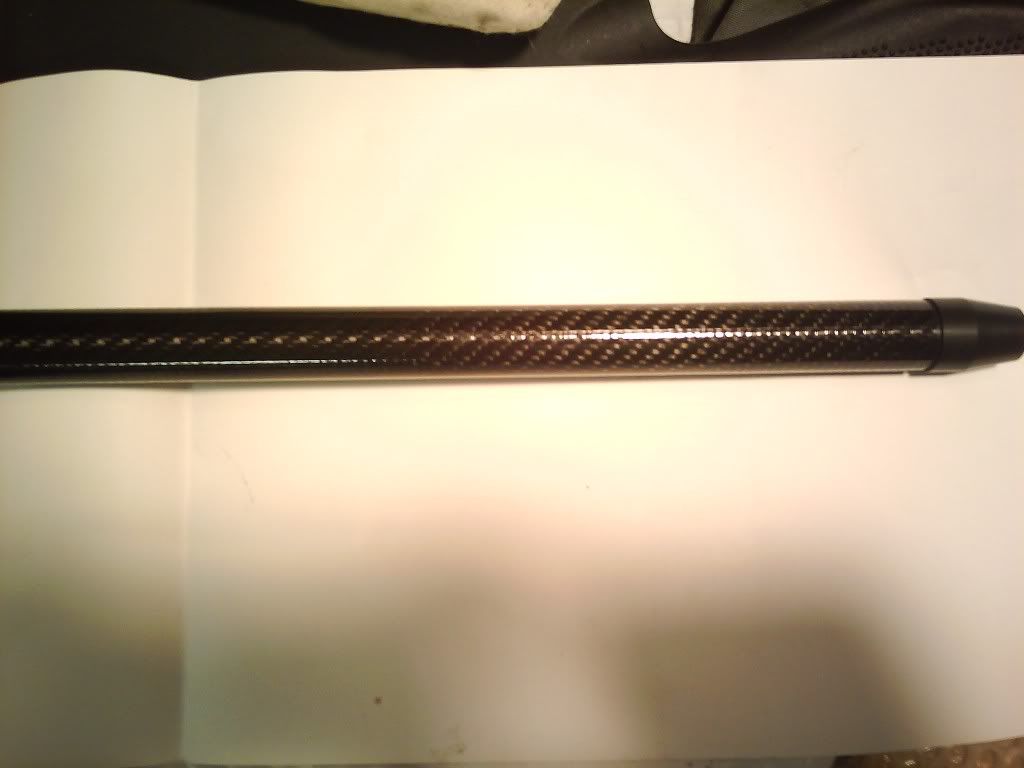

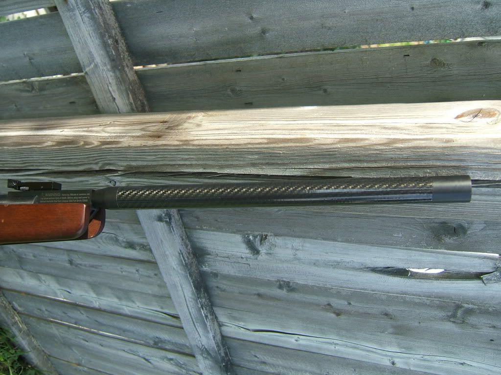

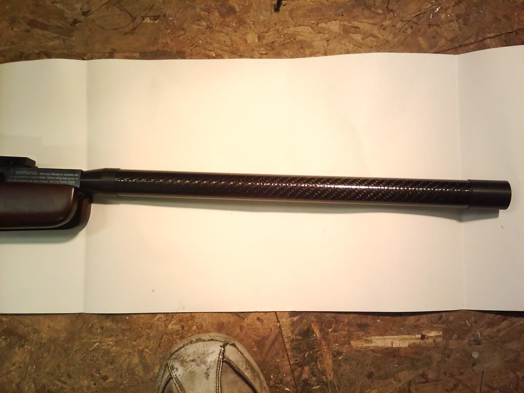

Next up was some carbon fiber goodness... the shroud body was made from 1"OD thick walled REAL CF tubing and the ends where machined from black delrin. A few crappy during pics and then a couple good finished product pics
fitting the end caps and boring to barrel diameter and exit hole

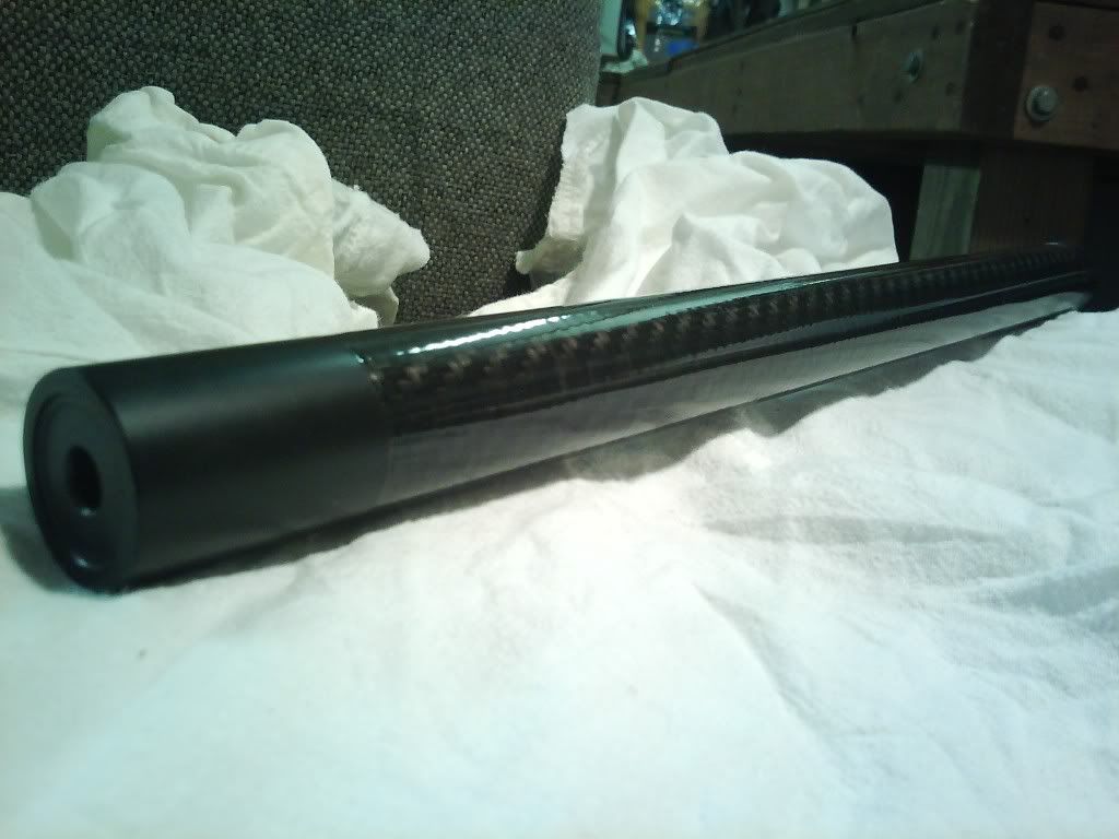

now ends turned to final diameter of the shroud and last fitting

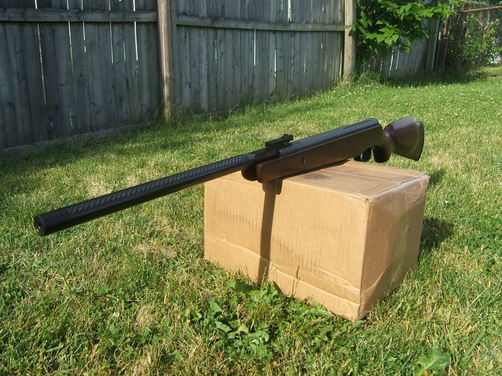

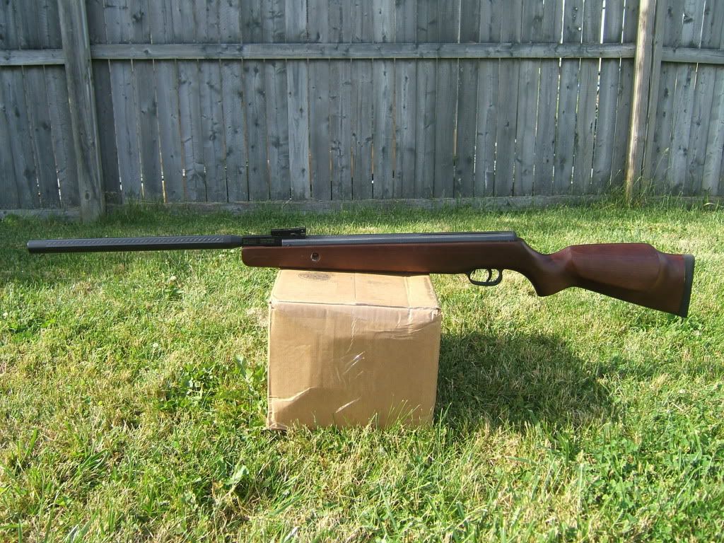

and here she is with about 8 coats of automotive clear all purty up and in the sun!!!
All in all I say she turned out real nice looking and after the tune in which I detuned the gun to shoot right at 930 fps so as she breaks in it should end up right at about 950 fps which is as fast as I think anyone should be driving a pellet especially if your going for accuracy.... If you're shooting faster then that then you should move to heavier pellet so your not flirting with that transonic barrier and blowing your accuracy to *(&^... she shoots as good as she looks
