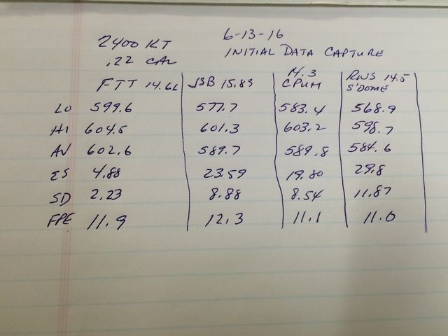

Here is my initial Chrony data with the 18" barrel.

That's solid! What size of FTT did you try?

Quote from: moorepower on July 18, 2016, 07:22:23 PM
5.53 are the only size I buy. It's the mid size of the group, and almost envy gun in my inventory likes them...some more than others.
