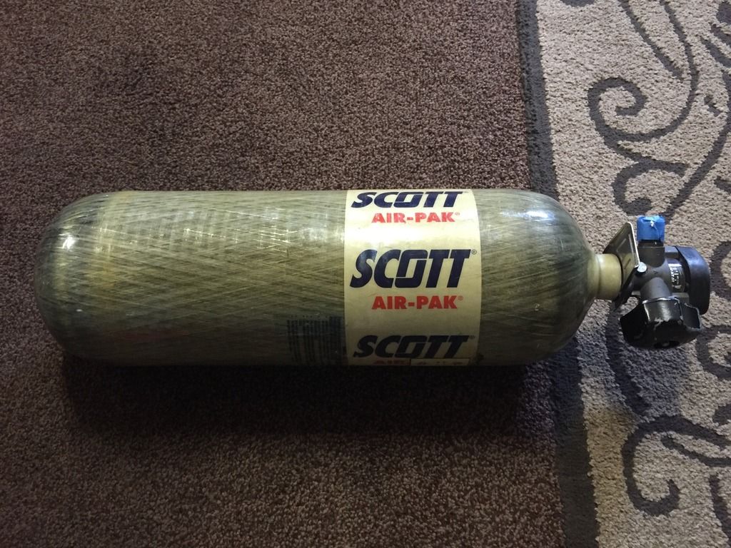

Very pleased with the new (to me) tank. I will be taking it to get hydro'ed Monday at the latest.
It's so nice, especially after all those others.

I would send it back.
Tanks DO get visuals. With every 5 yr hydrotest they are also visually inspected.
The aluminun "tank" is only a thin bladder wrapped with carbon fiber to give it strength. The thin aluminum's function is identical to the tube in a bicycle tire. It seals the pressure (but it can't hold the pressure by itself). Try to pressurize a tube without a tire around it (or the aluminum "tank" without the Carbon Fiber) for the hoop strength, and it will blow up like a balloon. Bottom line, DON'T rely on the aluminun for the strength if the Carbon Fiber is damaged.

Great analogy, Joe. Say what you will about the seller, he responded quickly to my complaints and returned my money quickly without any games. I really like the Scott tank. My local dive shop opens at noon today. So I'll take the tank in for a Hydro and a fill after I mow the lawn.
