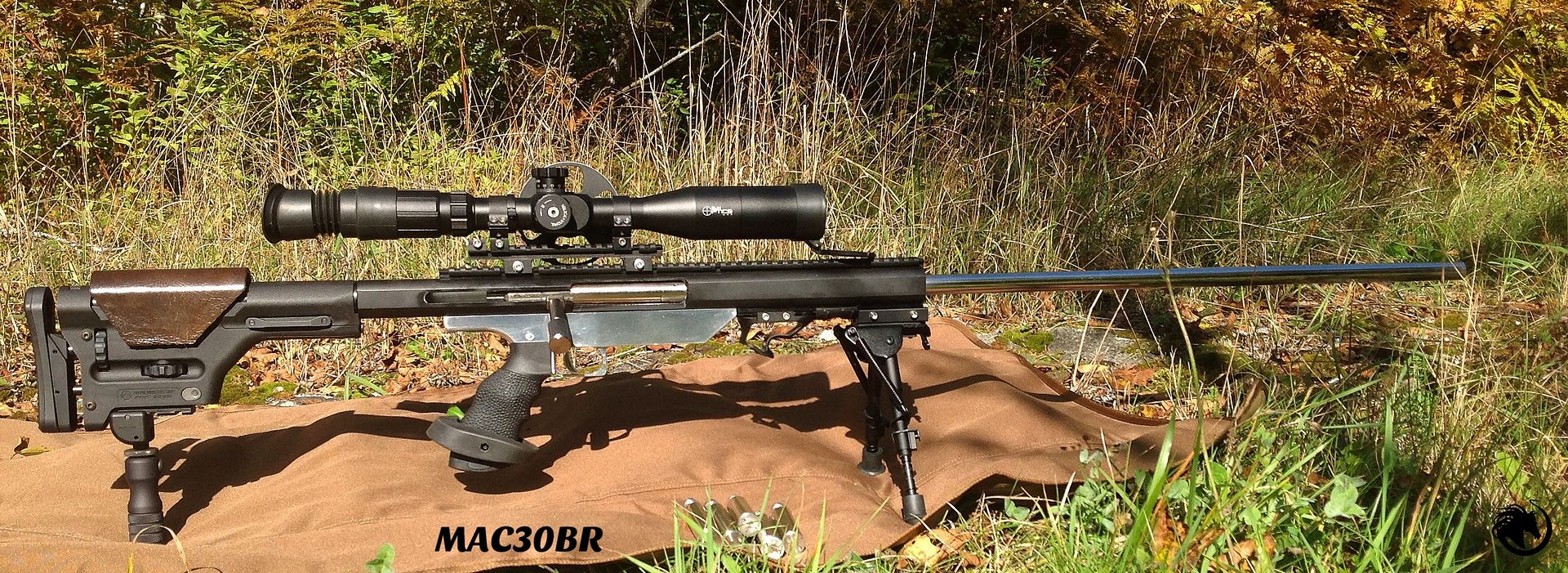

I am posting a couple of pics of my MAC but I should state this is
a one of a kind build.
So here are the numbers I am getting at this time:
JSB Kings 30 cal. 44.75gr @3500psi fill, average 820fps
JSB Kings 30 cal. 44.75gr @4000psi fill, average 840fps
JSB Kings 30 cal. 50.15gr @4000psi fill, average 816fps
If you had a 6000psi tank and filled to 5000-5500 shooting the
50.15gr JSB's you would probably even do better at accuracy,
but without a way to fill to those levels I cant test that theory.
I must say that these numbers are very do-able.
Inovairtech is planing on releasing a MAC30BR but it would have a
black lower and their regular AR15 style buttstock. I do believe
they "might" be offering a PRS stock option and if they do I would
highly recommend it and an Accu-Shot Mono-pod. For the PRS to work
you would need to add two screws. Let me know if interested I'll
send a picture.
I also think they are going to release a standard MAC30. The best
thing to do if you are interested in a 30 caliber MAC is call them direct.
The only CON I have at this time is the trigger, and I'm sure someone
out there probably knows how to make the change. The trigger is single
stage, there is no stop or tension or notch, you pull slowly till it
fires. I wish it had that stop just before it releases. Maybe I'll do
better when I get used to the release.
