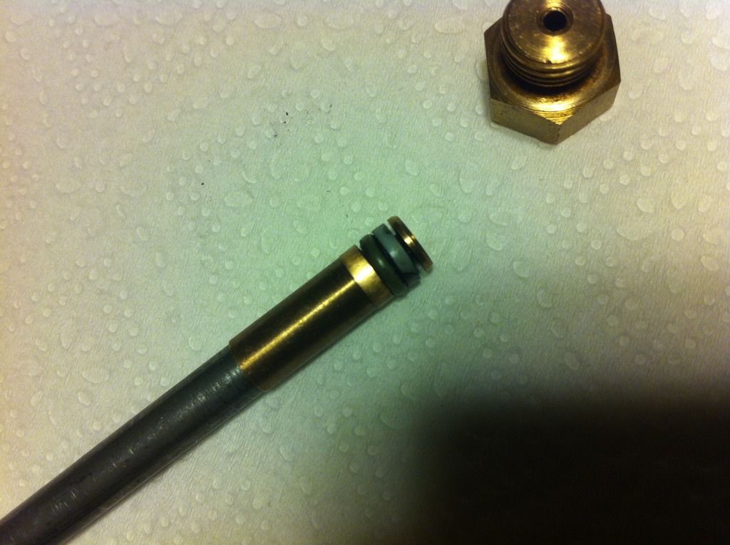

I have seen a lot of post about the benjamin hand pumps (I own one too) but didn't know there were several generations.
So, a friend sent me his Benjamin hand pump to rebuild as it was leaking when pumping.
I noticed it was different than my current one.
This one has a collar around the bottom of the shaft, and the intake is on the shaft, not on the domed base as is the newer one.
A quick call to sun optics, Duane Sorensen says it’s a gen2 pump, and the newer one is a gen 3.
All the orings are the same.
The failure was not the normal #8 007 oring, it was the #11 116 oring.
It was cut because the main shaft had come loose and in wiggling while pumping it was damaged.
I just thought I would pass this info along.
Gen 2 base intake on shaft (the hose to the gun isn't shown, but attaches to the brass fitting on top right of the dome)
Gen 3 base with desiccant filter
