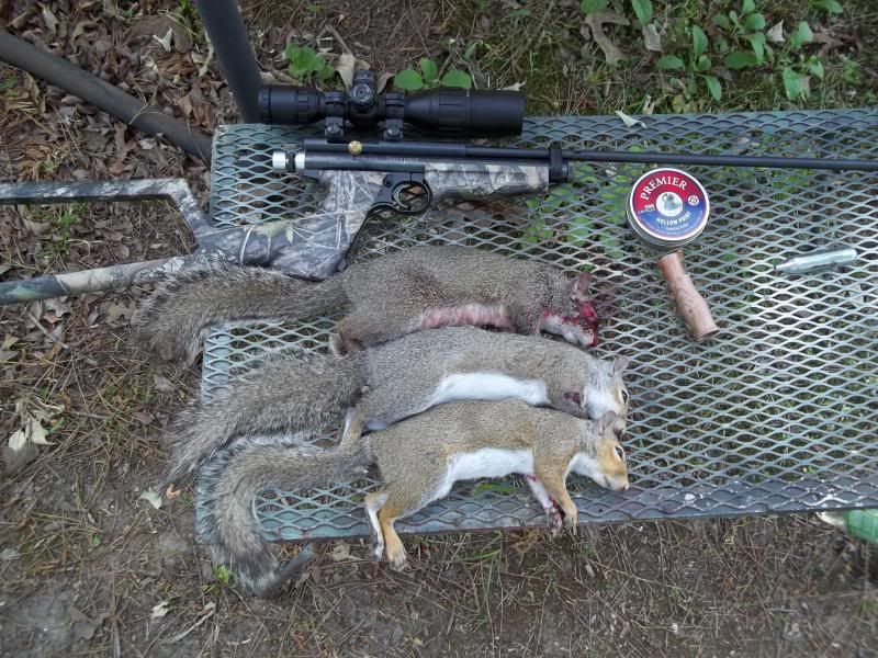

I have a modded valve and a power adjuster and I'm getting 600fps. That's on both a 18" and 24" barrel. If you can't do the modding you can buy one already done.
http://www.alchemyairwerks.com/store/p11/Alchemy_AirWerks_Rally_Ported_Higher_Performance_Valve_for_22xx_Crosman_CO2_Air_Guns.html
