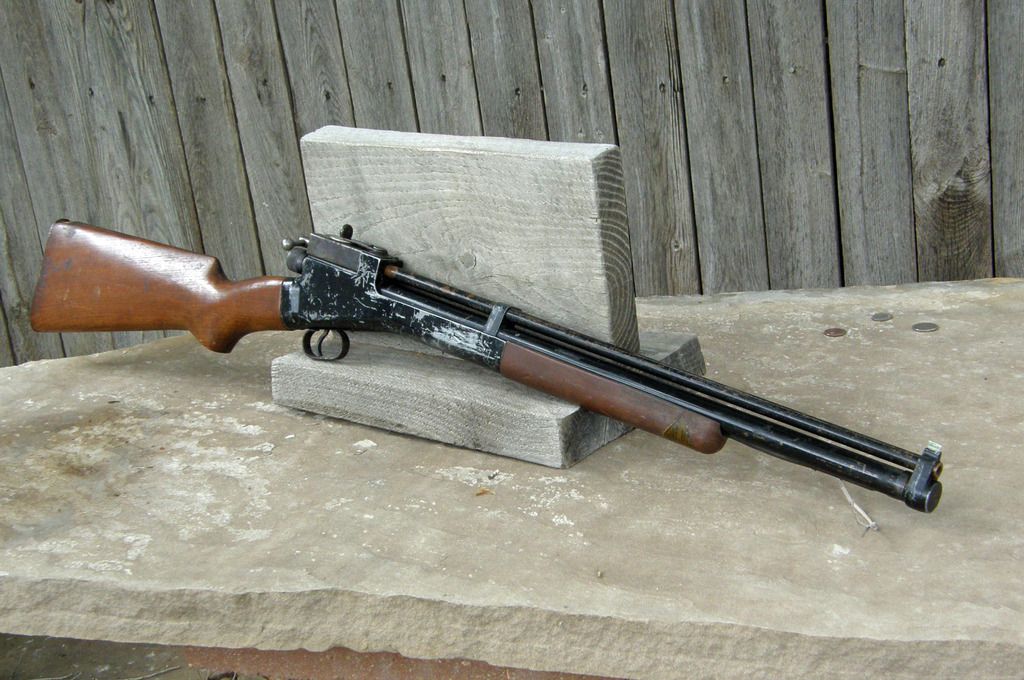

My brother called me last week while hitting a couple of flea markets. He found a pretty decent complete Crosman 140 for $20.00 so I told him to pick it up for me. Of course it was not holding air.
I tore it down today and played holy *(&^ getting the small plastic tubular bushing removed at the breach. This is the bushing that stumps a lot of folks because the breach screw runs through it. This busing has to be removed or the breach plug will not come out. I finally had to destroy it to get it out. One of those things because I played nice for over an hour.
With that said, does anyone have any suggestion for a replacement. I recon I need a replacement and every seal kit I've seen is absent of this bushing. Any help is appreciated!
