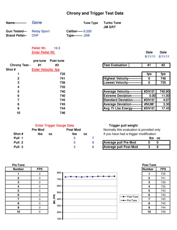

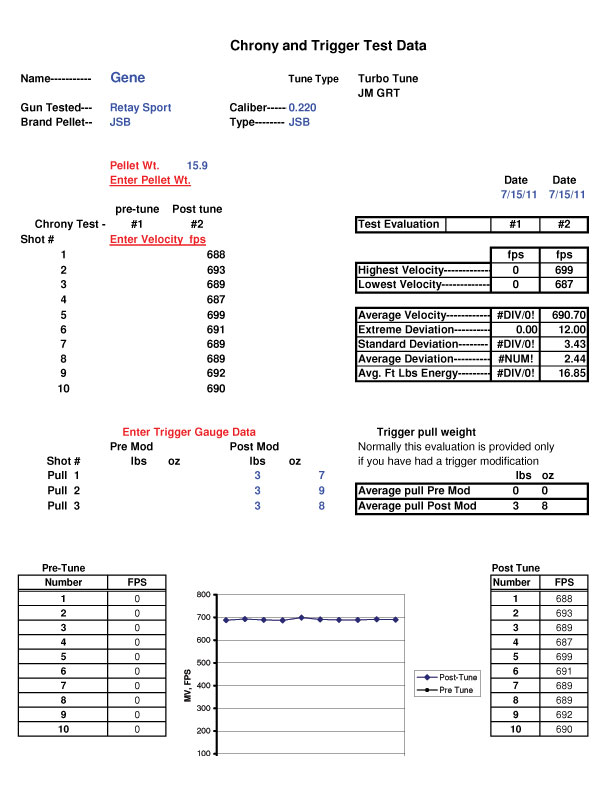

As an underlever springer it has a very nice gentle cocking cycle and shooting cycle. It is very accurate as well. I did not get a chance to set up targets for the review but I did allot of testing and shooting with different pellets. It seems to really like the JSB Exacts and CHP's.
Was getting tight clover leafs at 25 yards and 1" groups at 40 yards. Weather has not been cooperating here because of heat and then rain in afternoons.
I did run two strings of pellets across the chrony and you will see the results. For a new and fresh tune the numbers were quite suprising.
Two things that really got my attention were first the barrel. It was very dirty and took even a nylon brush and goo gone to clean it out good.
Second was putting it back together after I put new JM GRT spring in. Since the end cap is threaded and it made re assembly very difficult. You definitely need a spring compressor and good alignment.
Overall the Retay Sport is a well made and fine shooting gun. The metal work and stock are fantastic as well. The new style theoben trigger Retay has come up with is tunable. It is a one stage trigger but feels like a two stage to pull it.
