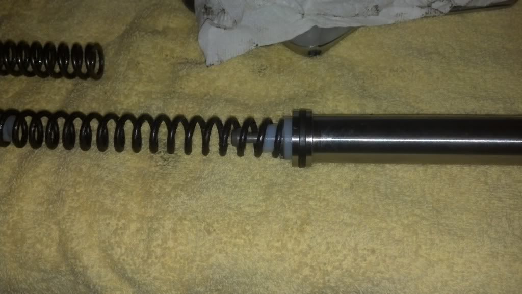

When I started this tonight I had some daylight left and thought I would be able to get it over the chrony. However after cleaning, taking my time as this was my virgin voyage in taking the rifle apart and a small fitting problem.
my problem i ran into was this.
I'm assuming from an engineering standpoint the front delrin guide should go in and replace the factory steel one. It wouldn't fit though and I knew i didnt want it to get stuck all the way in the botttom. So I got out the sand paper (several times) and when i thought I had it, stuck..... I got it out though minus a few words and a struggling sweat. so i left it out for now and re-installed the factory piece.
The sun had set so the chrono was not an option. Hopefully tomorrow I'll see what it is doing. I had to cycle it though, it was killing me. If the power/group consistency is there tomorrow I will be one happy camper. The shot cycle is pretty dang sweet (impressed). I had about 700 shots through the factory parts and it was acquiring a distinct spring noise, not a goose honk mind you but something was there lol. I also fitted the vortek seal adapter and oring until it was just a tad smoother than the original.

Just a quick comment ...
Using the factory STEEL top hat instead of the supplied plastic will change weight of the piston assembly and most likely power will be different.
In reading seems that more weight will increase power slightly, but also recoil a bit more.
Actual results would be interesting to see you actually document them. Shot with the factory weighted hat and without using the supplied one.
Anywho ... best of luck in your shakedown trials over the weekend !!!

Scott thats what I was thinking would be the outcome between the 2 as well. I'm going to spin the delrin top hat down on the drill press and compare next take down.
