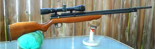

Overkill answer (lots of pixs)
October 29, 2010, 10:33:43 PM »
Each barrel has something it likes, and many pellets it doesn’t care for. Got to test everything that you have at first, then keep narrowing down the good from the not-so-good, and just live with whatever your barrel tells you it wants to shoot.
Just a plain-jane looking Discovery. Has had some work in lightening the striker, finging the right spring tension, and inletting that rear barrel band, but it's still a plain looking work-hose type rifle:
Usually make graphs keeping track of the adjustments. Basically, with a Discovery, the faster you get it to shoot, the fewer good shots per fill. Can be as exacting as you care to, or as casual, idea being to get a good handle on how the balance or power – fill pressure-shot count works out.
The graphs aren’t just fooling around. There is a relationship between vel. and point of impact, and even at short range, can see that in this set of targets. They graph pretty well predicts POI:
This is probably 1/10th the groups on file. Most of my initial testing is done at 20yards. That’s NOT enough range to sort out the great from the good, but it is enough range to sort out the bad.
So far, only these two have made the final cut. Would have been nice for it to shoot cheaper/locally available CP’s, but the barrel has the final say-so.
