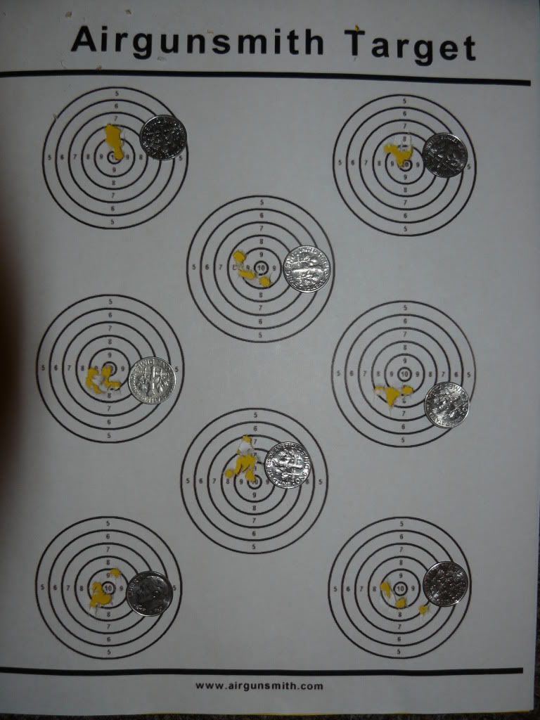

Compress the breech and tube together with a clamp and see if the breech screw will tighten more.
Test the velocity with a quick hard trigger pull vs squeeze. If it shoots slower on the squeeze mode the sear needs to be recut and hardened or replaced.
Factory hammer sears can get rounded off or come without the correct cut so when the trigger is pulled vigorously the velocity is 100 fps higher than when it is squeezed slowly.
The verticle group spreads you show seem to indicate there is some sort of variable speed issue.
