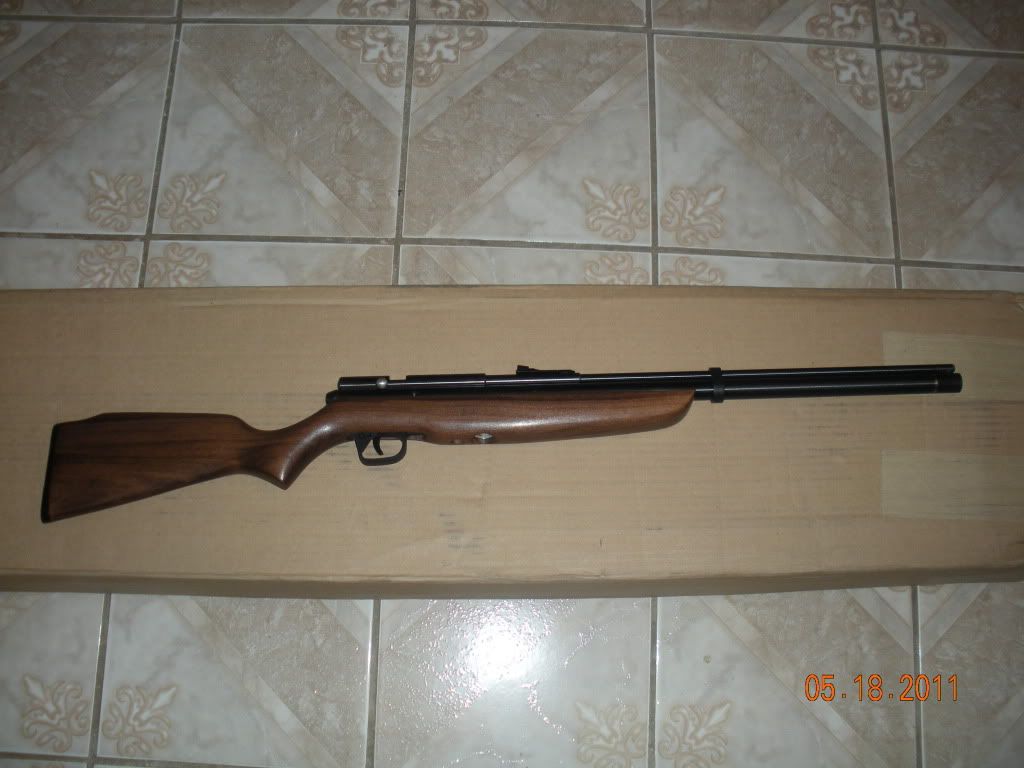

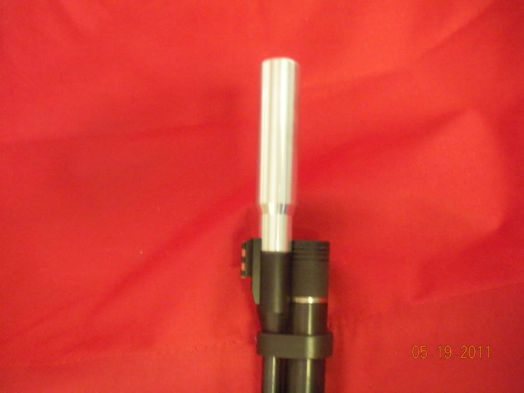

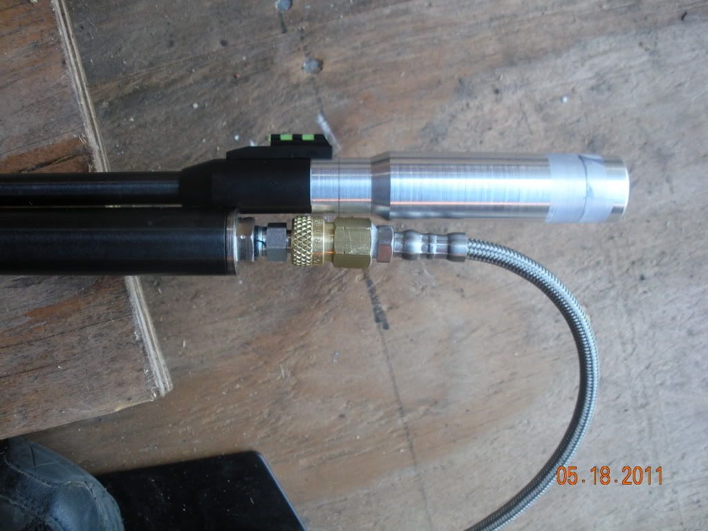

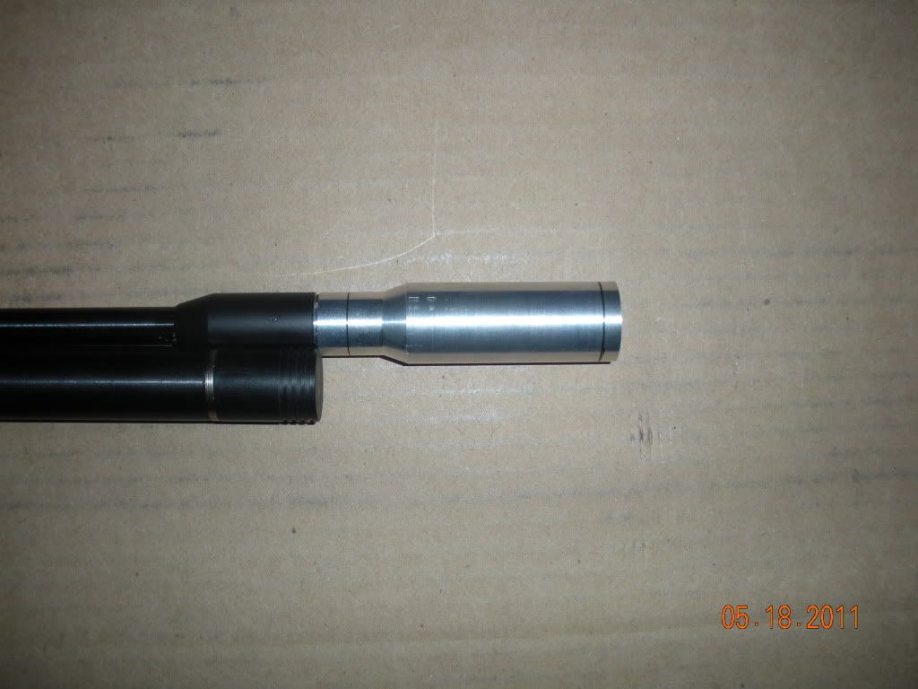

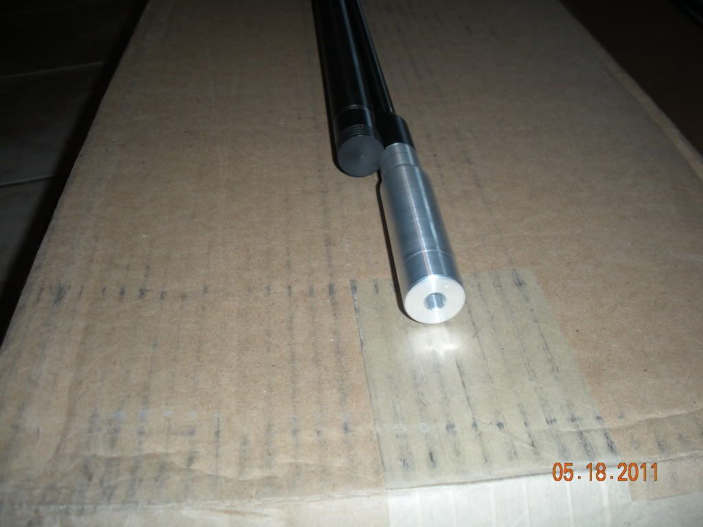

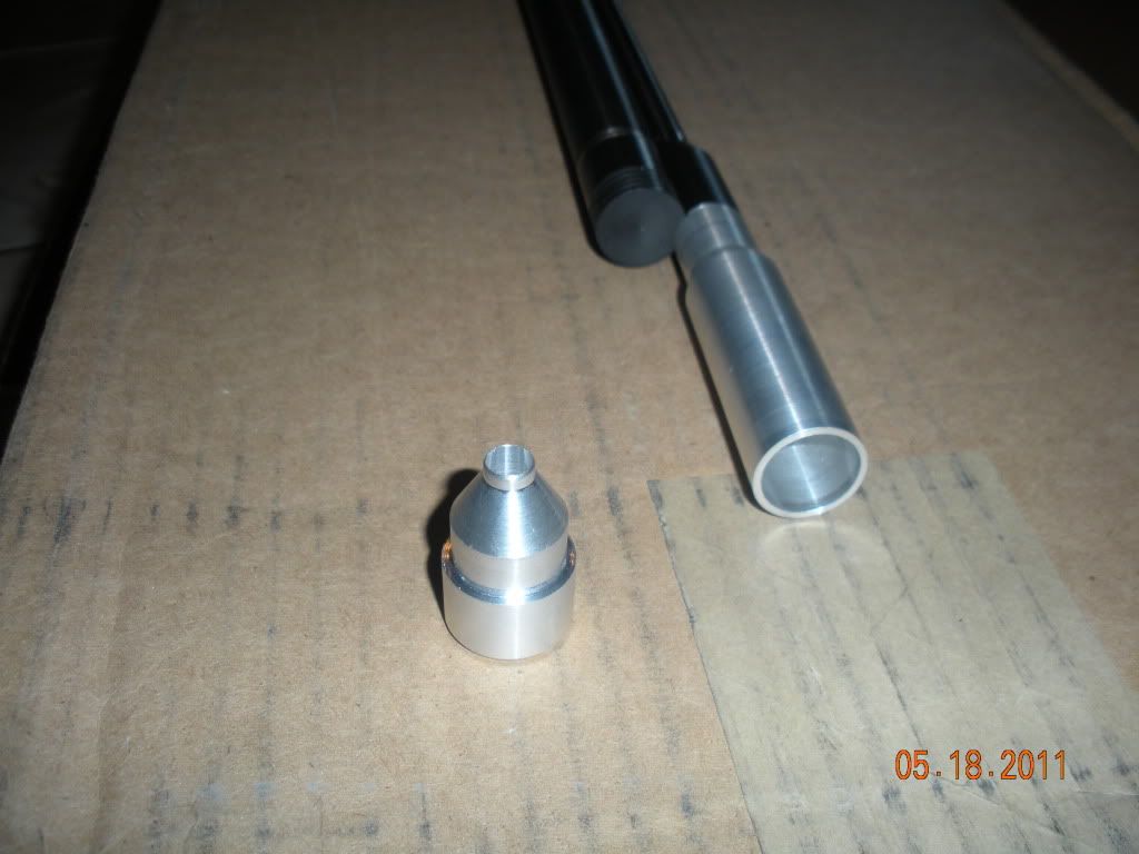

pick up a disco from crosman,this gun is pretty loud at 3 am....lol.
so i decided to make air stripper/muzzle brake.
i only fired 3 rounds through her,she came pre-charged with c02.

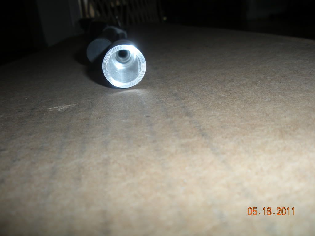

here's the start sofar,still machining the brake.....gotta bore it out some more,build the cap and cone...ect.
im trying to build the brake and still beable to use the stock fill cap too.
plan on getting another barrel clamp,power adjuster,install a 4-16x40 glass.
maybe make a stock for her aswell.
this will be a slow build.
later on today ill pass her through the chrony and scope her.

thanx guys....glad to be here,but right now i wont be that active,ive got alot going on at the moment.

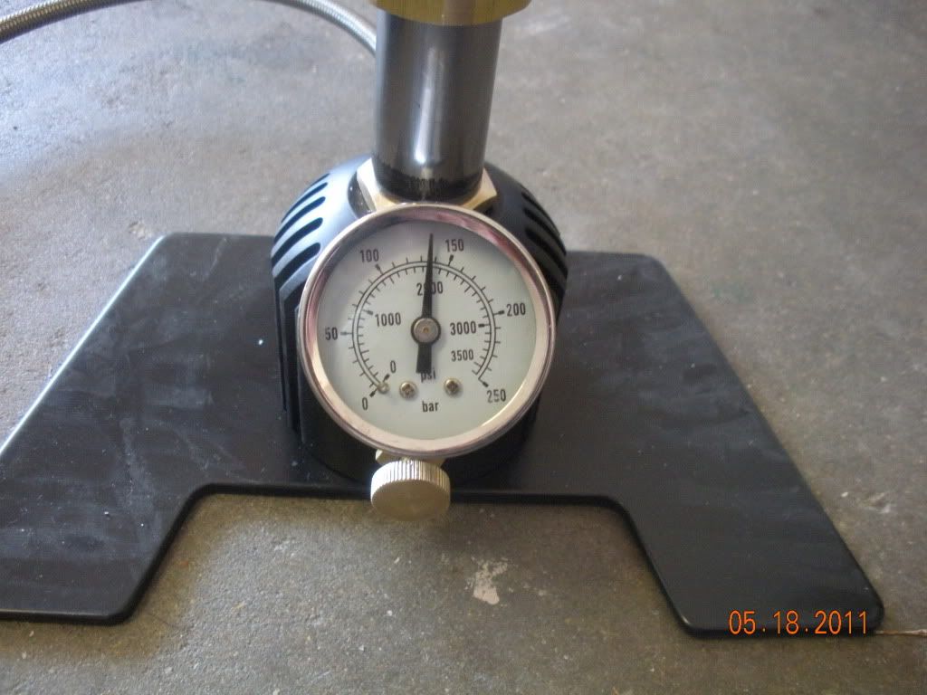

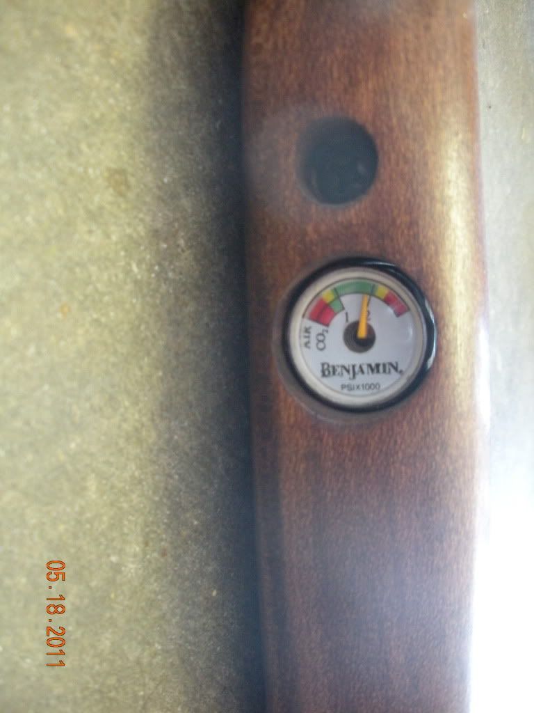

bleed down the disco,pumped up to 2100 psi on the pump,to reach the full green on the disco.
estimated 200 pumps.after 1200 psi the pump really puts out.

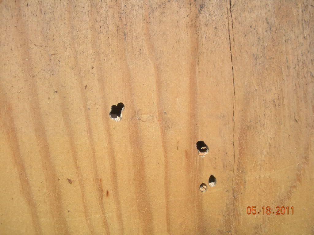

done a quick sight-in on the manual sights at 12 yards.....im very impressed.
2 1 hole groups while sighting in.
will post up proper grouping later.

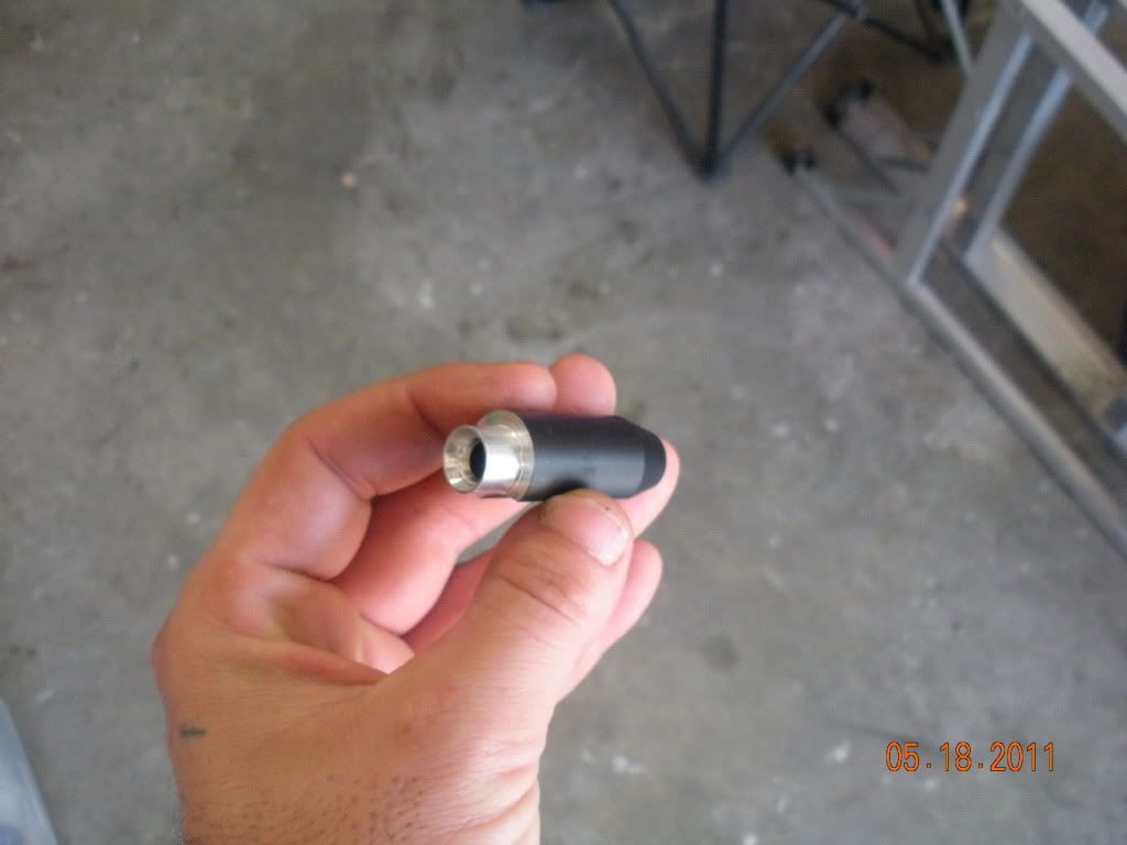

brake isnt finished,but i tried it anyway,just the hollow chamber and cap severly quietened the gun,so i removed it from the gun after 2 shots....big difference.need to port the brake to make her legal.

second fill was faster to pump up,42 pumps to reach 1000 psi on the pump,touching the green on the gauge.
59 pumps from 1000 psi to 2200 psi on the pump,full green on the guns gauge.
101 pumps total to fill the gun completly empty to full.

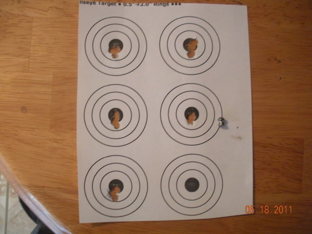

this gun is a dime 10 shot group at 12 yards with open sights.
id imagine with a good glass you could shrink that down abit.

thanx jonny....im looking foward to doing the work aswell.
everything paul capello states about this gun is true,his review accuratly describes the performance.
have to get some new scope mounts to fit the rail,so it will be open sighter for now.

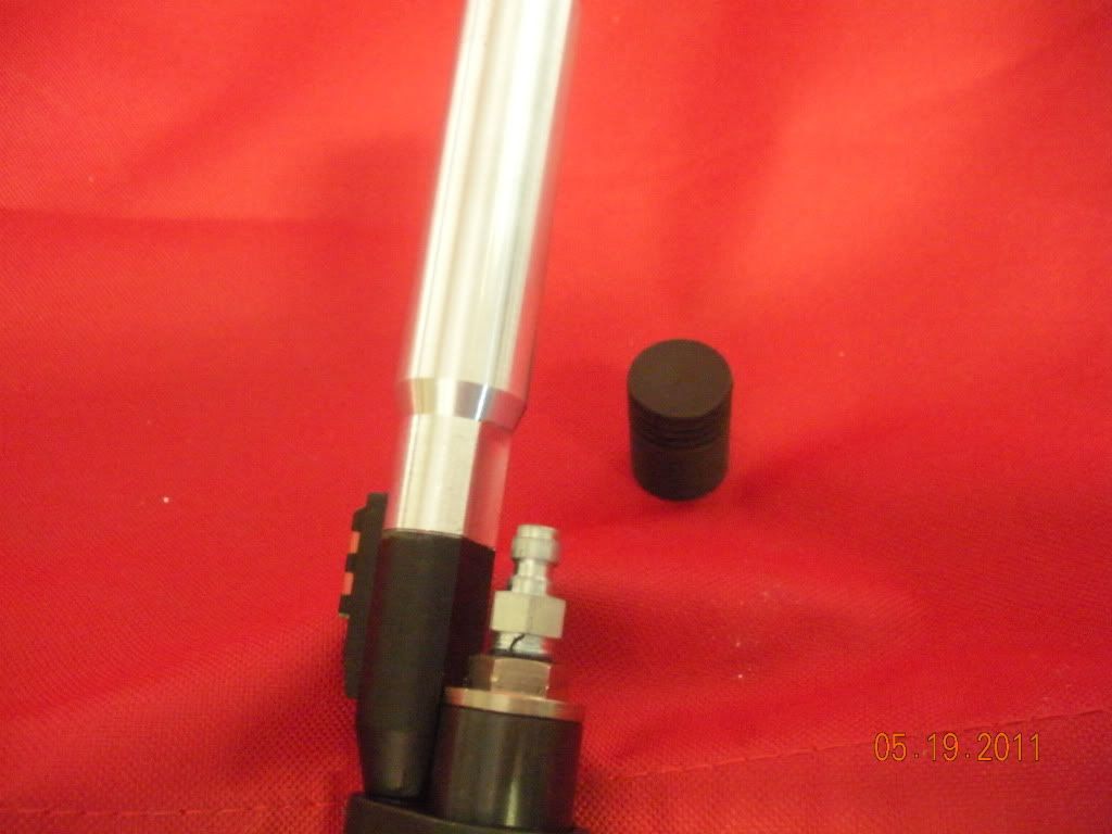

heres a few pics of a few 12 yard 5 shot groups,and the fit of the foster coupling on the gun with the break installed.easy on and off.

May 18, 2011, 10:36:22 PM »
tko makes great quality items for a low price.....just to clarify,in my previous post....when i stated that tko's were cheaper......i meant cheaper to produce,not cheaper built.
i have 3 hours tied up in building my brake,and its only half way built.

thanx guys,i love this new gun....my first pcp.
ive added the barrel clamp from my 2260,and my 35 yard groups are down to 1/2 inch,3/4 average.
with a 3-9x40 cp,but everytime i put it down....gotta resight her.
before the extra clamp i was around 1 inch to 1.5 at 35 yards.
i dont know how many times anyone can state how great this starter gun is....lol.
done alittle work on the brake.....actually started over,this one is solid,kinda acts like a muzzle weight.
plus it looks great.later on ill finish the first design,i dont have a mill so slotting the ports will take forever with a drill and file set.
