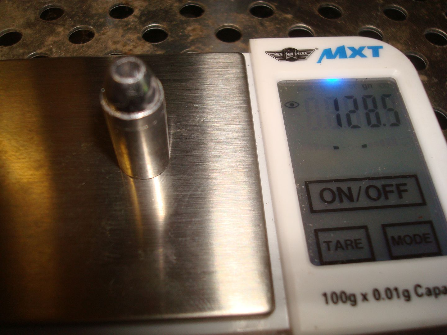

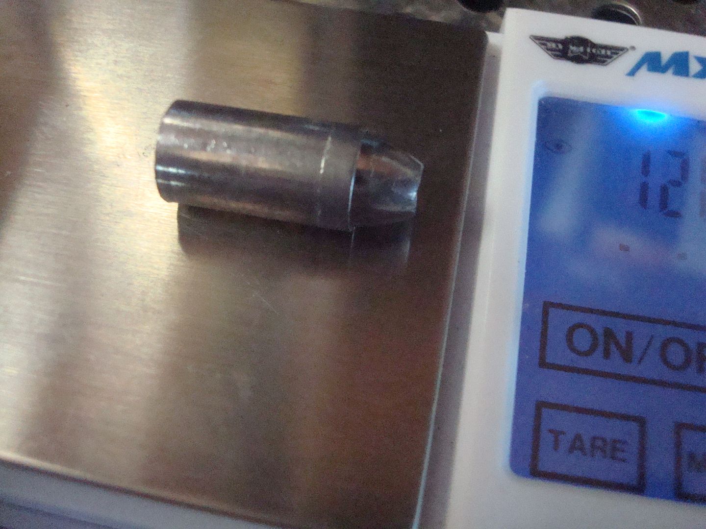

You are never going to get the energy out of a 201 or 202 that you get out of a Gargoyle . I have a Gargoyle by Dan that now makes the XP line of rifles and this is what it does with a standard valve . I have a low psi valve and a high psi valve as well .
And from my experince with my 201 it liked a .357 and 5-12 bhn lead . Marvin
